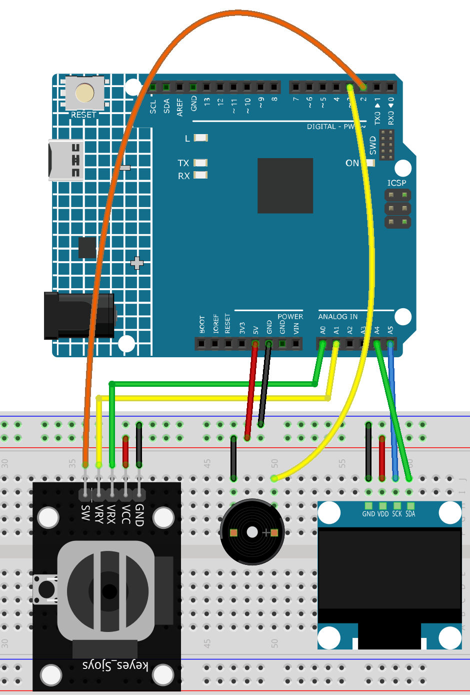

Wiring
../_images/tetris3.0_bb.png
Common Connections:
  • OLED Display Module
    • SDA: Connect to A4 on the Arduino.
    • SCK: Connect to A5 on the Arduino.
    • VCC: Connect to breadboard’s red power bus.
  • Joystick Module
    • VRY: Connect to A1 on the Arduino.
    • VRX: Connect to A0 on the Arduino.
    • SW: Connect to 2 on the Arduino.
  • Passive Buzzer
    • +: Connect to 3 on the Arduino.
    • -: Connect to breadboard’s negative power bus.
