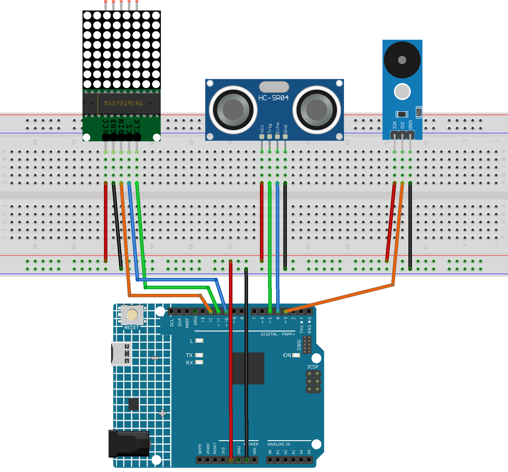

Wiring
../_images/Parking_Sensor_1.0_bb.png
Common Connections:
  • Passive Buzzer Module
    • I/O: Connect to 3 on the Arduino.
  • MAX7219 Dot Matrix Module
    • CLK: Connect to 11 on the Arduino.
    • CS: Connect to 10 on the Arduino.
    • DIN: Connect to 12 on the Arduino.
  • Ultrasonic Sensor Module
    • Trig: Connect to 5 on the Arduino.
    • Echo: Connect to 4 on the Arduino.
