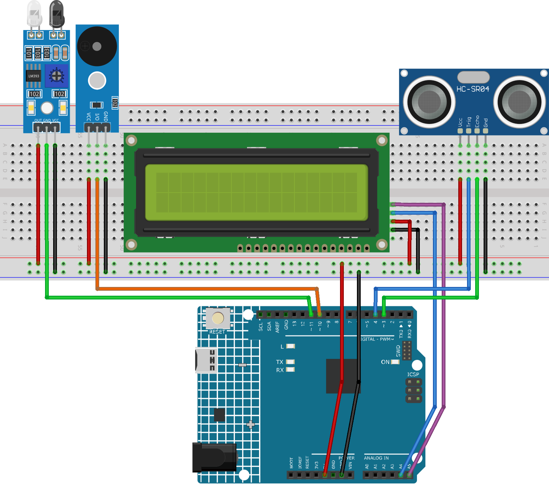

This Arduino project detects speed using IR sensor and Ultrasonic Sensor Module. When an object passes the first sensor, a timer starts; it stops at the second sensor.
QUANTITY
Arduino UNO R4 Minima
USB Type-C cable
Wires
Several
IR Obstacle Avoidance Sensor Module
I2C LCD 1602
Buzzer Modudle
Wiring
../_images/Speed_Detection5.0_bb.png
Common Connections:
  • I2C LCD 1602
  • Ultrasonic Sensor Module
    • Trig: Connect to 4 on the Arduino.
    • Echo: Connect to 3 on the Arduino.
  • IR Obstacle Avoidance Sensor Module
    • OUT: Connect to 11 on the Arduino.
  • Buzzer Module
    • I/0: Connect to 10 on the Arduino.
