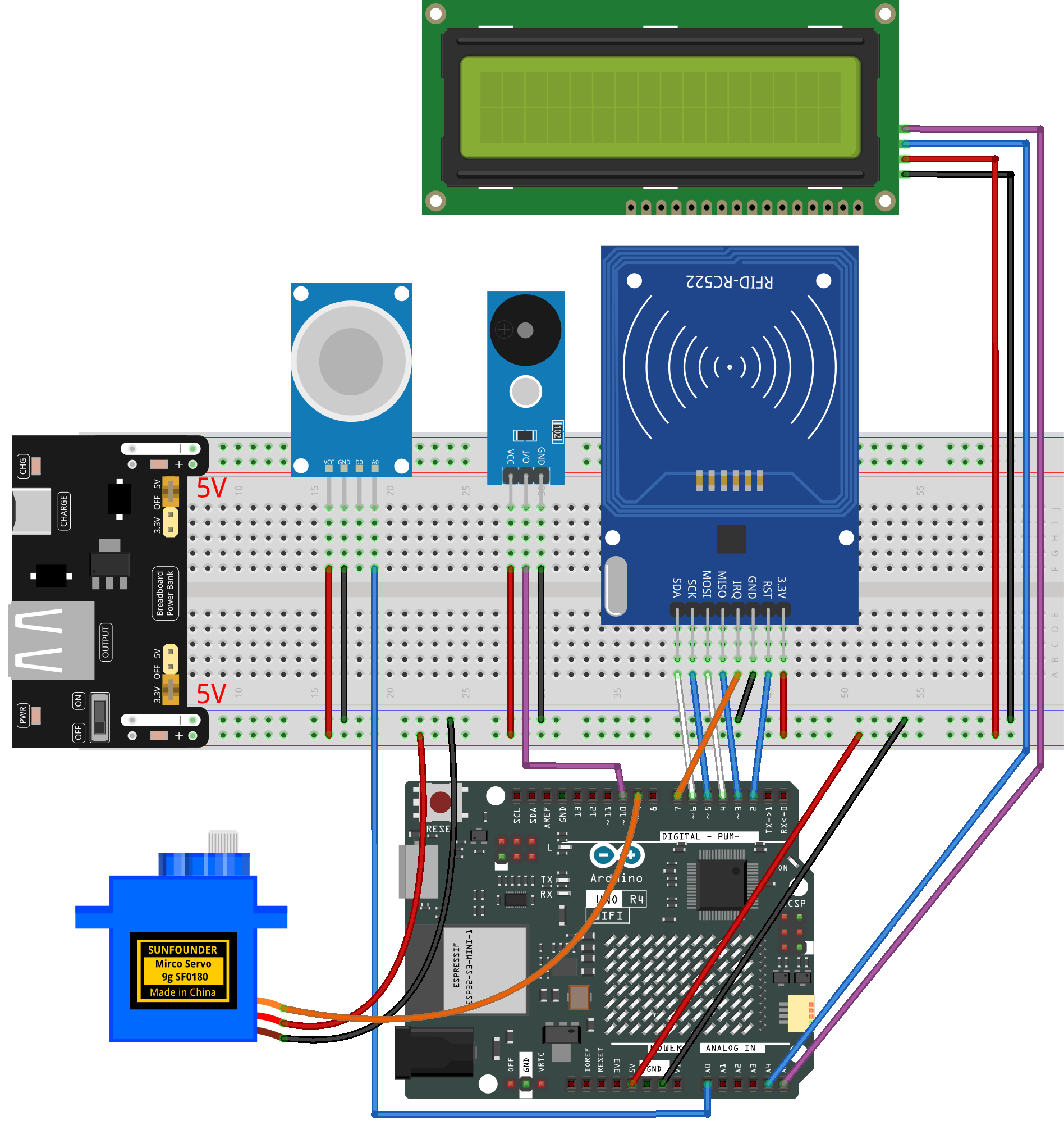

Wiring
../_images/RFID_Access6.0_bb.png
Common Connections:
  • MFRC522 Module
    • IRQ: Connect to 7 on the Arduino.
    • SDA: Connect to 6 on the Arduino.
    • SCK: Connect to 5 on the Arduino.
    • MOSI: Connect to 4 on the Arduino.
    • MISO: Connect to 3 on the Arduino.
    • RST: Connect to 2 on the Arduino.
    • 3.3V: Connect to breadboard’s passive power bus.
  • MQ-2 Gas Sensor Module
    • A0: Connect to A0 on the Arduino.
  • Buzzer Module
    • I/0: Connect to 10 on the Arduino.
  • Digital Servo Motor
  • I2C LCD 1602
