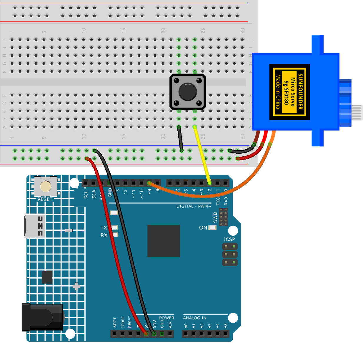

Wiring
../_images/feed_bb.png
Common Connections:
  • Digital Servo Motor
    • Connect to breadboard’s positive power bus.
    • Connect to breadboard’s negative power bus.
    • Connect to 9 on the Arduino.
  • Button
    • Connect to the breadboard’s negative power bus, and the other end to 2 on the Arduino board.
