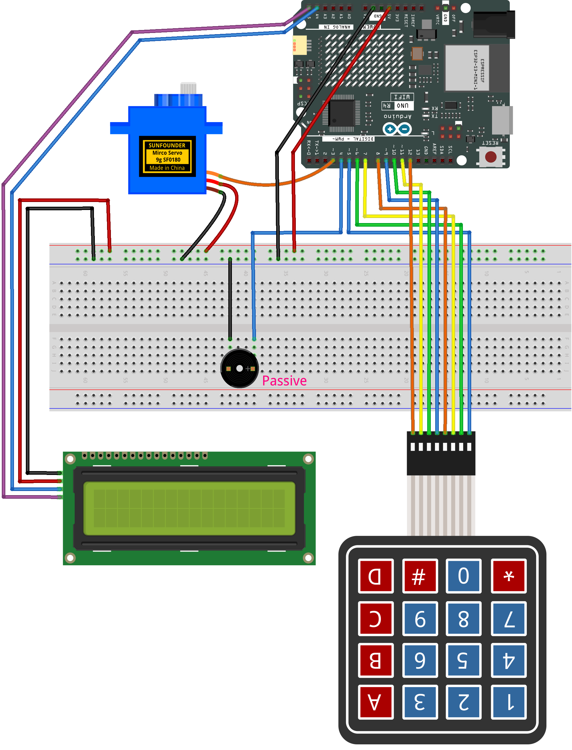

Wiring
../_images/PIN_Lock2.0_bb.png
Common Connections:
  • Keypad
    • RowPins: Connect to 5 to 8 on the Arduino.
    • ColPins: Connect to 9 to 12 on the Arduino.
  • I2C LCD 1602
  • Passive buzzer
    • +: Connect to 4 on the Arduino.
  • Digital Servo Motor
    • Connect to 3 on the Arduino.
