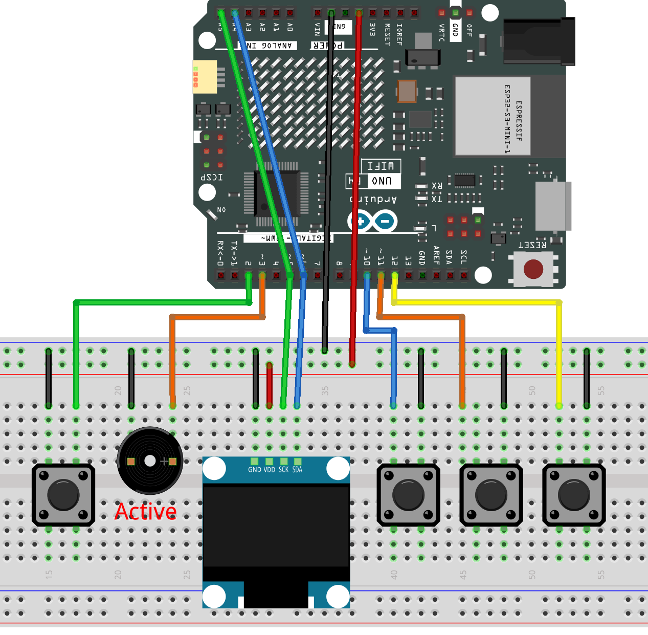

Wiring
../_images/BitFriend_bb.png
Common Connections:
  • OLED Display Module
    • SDA: Connect to A4 on the Arduino.
    • SCK: Connect to A5 on the Arduino.
    • VCC: Connect to breadboard’s red power bus.
  • Button
    • button1: Connect to the breadboard’s negative power bus, and the other end to 2 on the Arduino board.
    • button2: Connect to the breadboard’s negative power bus, and the other end to 10 on the Arduino board.
    • button3: Connect to the breadboard’s negative power bus, and the other end to 11 on the Arduino board.
    • button4: Connect to the breadboard’s negative power bus, and the other end to 12 on the Arduino board.
  • Active Buzzer
    • +: Connect to 3 on the Arduino.
    • -: Connect to breadboard’s negative power bus.
