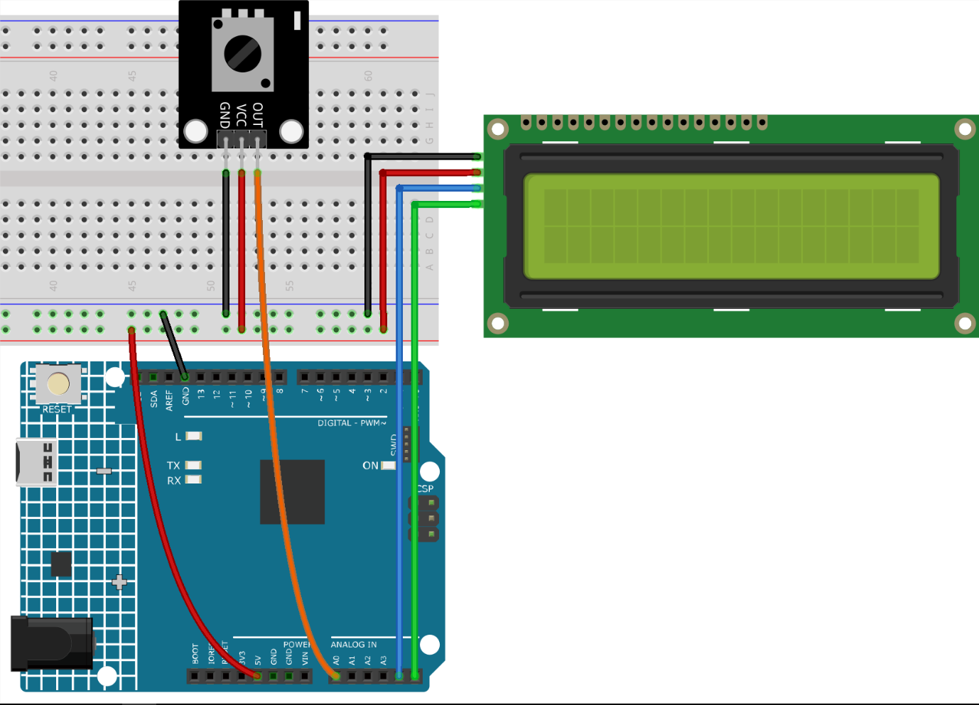

Wiring
../_images/potentiometer_value.png
Common Connections:
  • Potentiometer Sensor Module
    • OUT: Connect to A0 on the Arduino.
    • VCC: Connect to breadboard’s red power bus.
  • I2C LCD 1602
    • SDA: Connect to A4 on the Arduino.
    • SCL: Connect to A5 on the Arduino.
