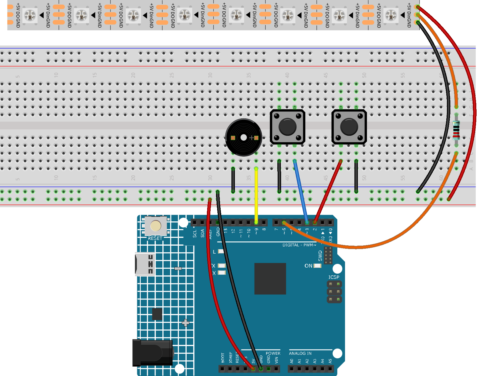

Wiring
../_images/tug_of_war_bb.png
Common Connections:
  • Button
    • button1: Connect to the breadboard’s negative power bus, and the other end to 2 on the Arduino board.
    • button2: Connect to the breadboard’s negative power bus, and the other end to 3 on the Arduino board.
  • Passive Buzzer
    • +: Connect to 9 on the Arduino.
    • -: Connect to breadboard’s negative power bus.
  • LED Strip
    • Din: Connect a to 220Ω resistor then to 6 on the Arduino.
    • +5V: Connect to breadboard’s passive power bus.
