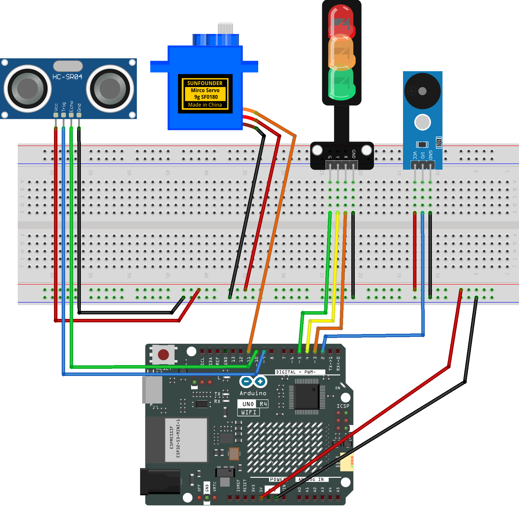

Wiring
../_images/Trash_Can3.0_bb.png
Common Connections:
  • Digital Servo Motor
    • Connect to 11 on the Arduino.
  • Ultrasonic Sensor Module
    • Trig: Connect to 9 on the Arduino.
    • Echo: Connect to 10 on the Arduino.
  • Buzzer Module
    • I/0: Connect to 2 on the Arduino.
  • Traffic light LED
    • R: Connect to 3 on the Arduino.
    • Y: Connect to 4 on the Arduino.
    • G: Connect to 5 on the Arduino.
