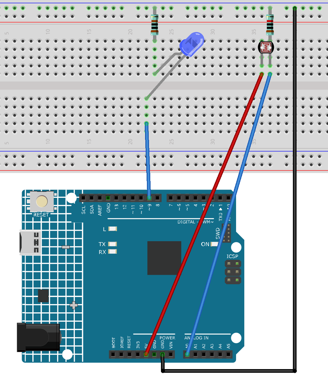

Wiring
../_images/night_led_bb.png
Common Connections:
  • LED
    • Blue: Connect the LED anode to 9 on the Arduino, and the cathode to a 1kΩ resistor, then to the negative power bus on the breadboard.
  • Photoresistor
    • VCC: Connect to A0 on the Arduino.
