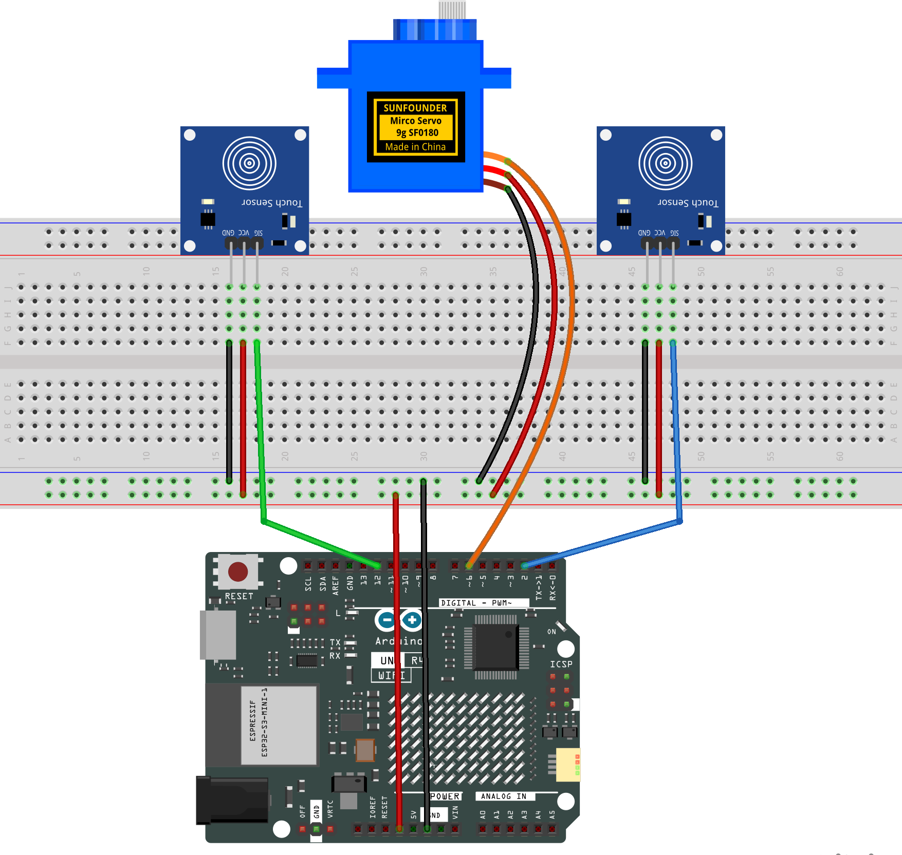

This project uses two touch sensors to control a servo motor. Press and hold a sensor to move the servo toward 0° or 180° in 5° steps. Both pressed = no movement. Initial angle: 90°.
QUANTITY
Arduino UNO R4 WIFI
USB Type-C cable
Wires
Several
Touch Sensor Module
Rotary Encoder Module
Wiring
../_images/Servo_Control4.0_bb.png
Common Connections:
  • Digital Servo Motor
    • Connect to 6 on the Arduino.
  • Touch Sensor Module 1
    • SIG: Connect to 2 on the Arduino.
  • Touch Sensor Module 2
    • SIG: Connect to 12 on the Arduino.
