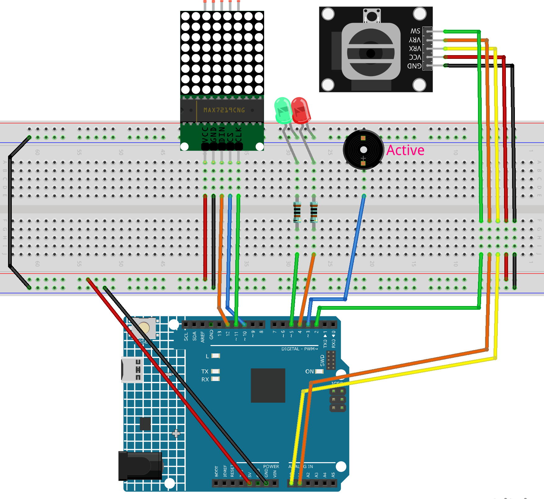

In this lesson, we’ll use a MAX7219 Dot Matrix Module, a joystick module, and an Arduino board to play a Snake game.
The snake’s movement will be controlled using the joystick.
QUANTITY
USB Type-C cable
Wires
Several
Joystick Module
Active Buzzer
Wiring
../_images/Snake_Game2.0_bb.png
Common Connections:
  • MAX7219 Dot Matrix Module
    • CLK: Connect to 11 on the Arduino.
    • CS: Connect to 10 on the Arduino.
    • DIN: Connect to 12 on the Arduino.
  • Joystick Module
    • SW: Connect to 2 on the Arduino.
    • VRY: Connect to A1 on the Arduino.
    • VRX: Connect to A0 on the Arduino.
  • Active Buzzer
    • +: Connect to 3 on the Arduino.
  • LEDS
    • Green: Connect the LED anode to a 1kΩ resistor, then to 5 on the Arduino, and the cathode to the negative power bus on the breadboard.
    • Red: Connect the LED anode to a 1kΩ resistor, then to 4 on the Arduino, and the cathode to the negative power bus on the breadboard.
