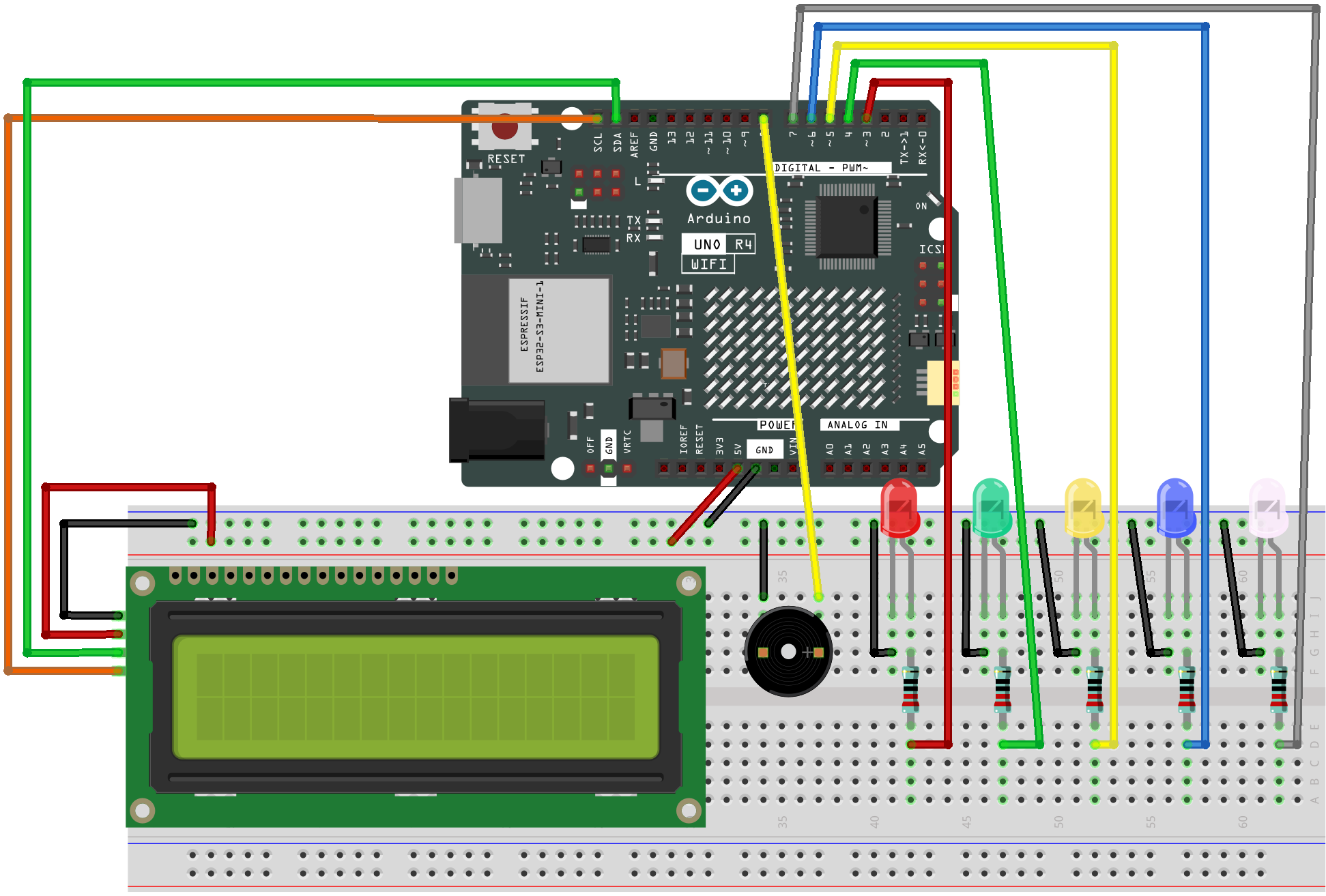

Wiring
../_images/happy_birthday_bb.png
Common Connections:
  • Active Buzzer
    • +: Connect to 8 on the Arduino.
    • -: Connect to breadboard’s negative power bus.
  • LED
    • Connect the LEDs cathode to the negative power bus on the breadboard, and the LEDs anode to a 22Ω resistor then to 3 to 7 on the Arduino.
  • I2C LCD 1602
    • SDA: Connect to SDA on the Arduino.
    • SCL: Connect to SCL on the Arduino.
    • VCC: Connect to breadboard’s red power bus.
