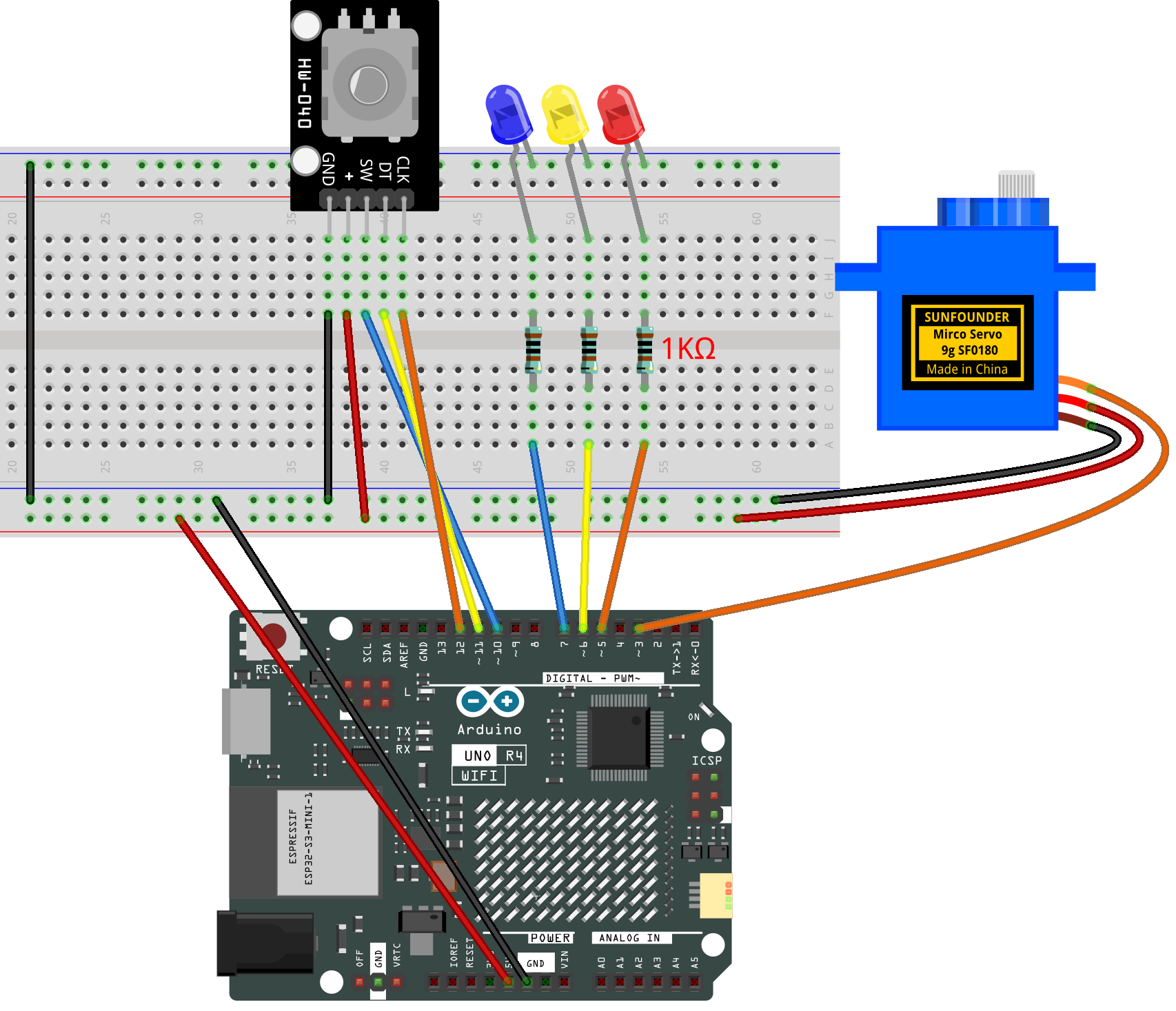

This project creates a servo angle controller using an Arduino, a rotary encoder, a push button, and three LEDs.
Users rotate the encoder to adjust the servo angle and press the button to toggle step sizes (1°, 5°, 10°). The LED color indicates the current step size: red = 1°, yellow = 5°, blue = 10°.
QUANTITY
Arduino UNO R4 WIFI
USB Type-C cable
Wires
Several
Digital Servo Motor
Rotary Encoder Module
1kΩ resistor
Wiring
../_images/Servo_Control3.0_bb.png
Common Connections:
  • Digital Servo Motor
    • Connect to 3 on the Arduino.
  • rotary encoder
    • CLK: Connect to 12 on the Arduino.
    • DT: Connect to 11 on the Arduino.
    • SW: Connect to 10 on the Arduino.
  • LED
    • Blue Connect the LEDs anode to a 1kΩ resistor then to the negative power bus on the breadboard, and the LEDs cathode to 7 on the Arduino.
    • Yellow Connect the LEDs anode to a 1kΩ resistor then to the negative power bus on the breadboard, and the LEDs cathode to 6 on the Arduino.
    • Red Connect the LEDs anode to a 1kΩ resistor then to the negative power bus on the breadboard, and the LEDs cathode to 5 on the Arduino.
