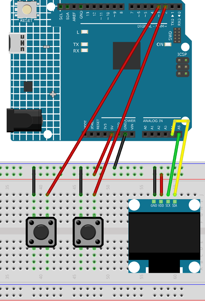

Wiring
../_images/digital_dice2.0_bb.png
Common Connections:
  • OLED Display Module
    • SDA: Connect to A4 on the Arduino.
    • SCK: Connect to A5 on the Arduino.
    • VCC: Connect to breadboard’s red power bus.
  • Buttons
    • Normal Button: Connect to the negative power bus on the breadboard, and the other end to 2 on the Arduino board.
    • Cheat Butto: Connect to the negative power bus on the breadboard, and the other end to 3 on the Arduino board.
