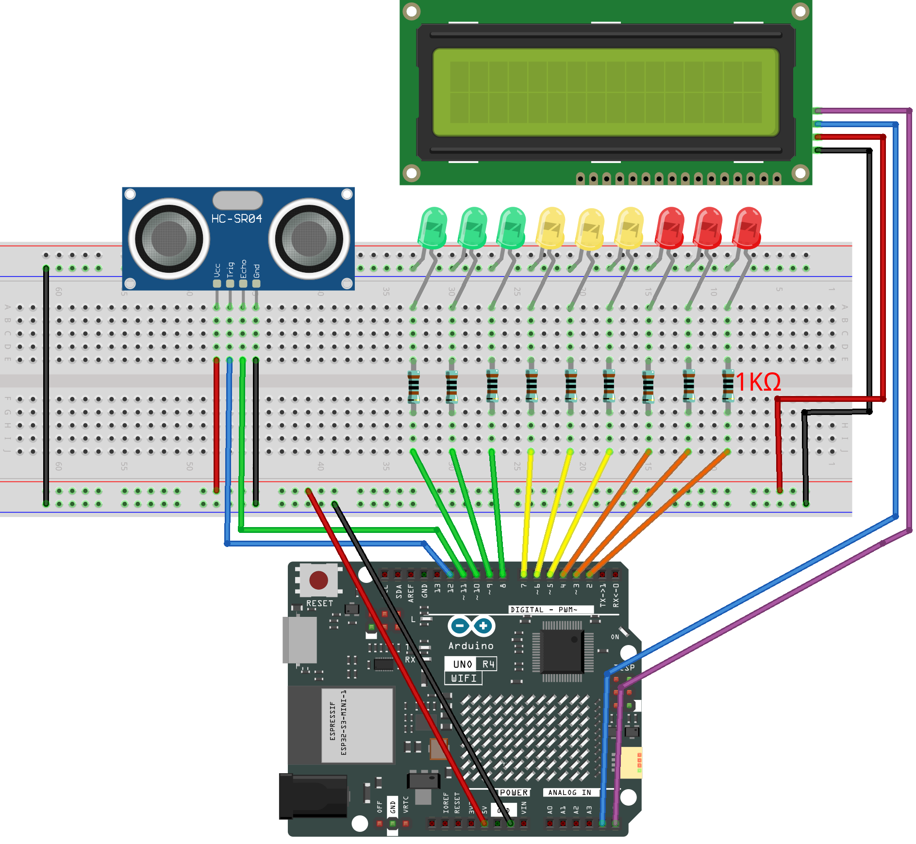

In this project, we use an ultrasonic sensor and a 1602 LCD and three groups of LEDs (green, yellow, red) to simulate a radar-style proximity alert system with the Arduino board.
The system measures the distance to an object and activates different LED groups based on how close the object is: green LEDs indicate a safe distance (≤15 cm), yellow LEDs warn that the object is getting closer (≤10 cm), and red LEDs signal a critical proximity alert (≤5 cm). The LEDs turn on from left to right and turn off from right to left to enhance the visual effect.

Wiring
../_images/Distance_Display3.0_bb.png
Common Connections:
  • LED
    • Connect the LEDs cathode to the negative power bus on the breadboard, and the LEDs anode to a 1kΩ resistor then to 2 ~ 10 on the Arduino.
  • Ultrasonic Sensor Module
    • Trig: Connect to 12 on the Arduino.
    • Echo: Connect to 11 on the Arduino.
  • I2C LCD 1602
