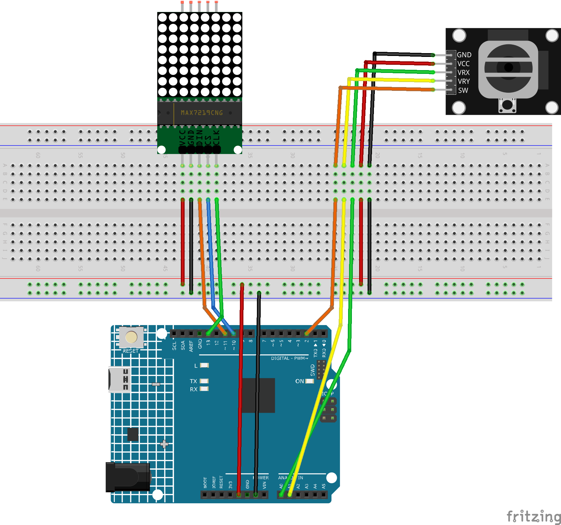

In this project, we use a MAX7219 8x8 Dot Matrix module, a joystick, and an Arduino board to play a classic Tetris game.
The falling blocks are controlled using the joystick for left, right, down, and rotation.
Required Components
SN
COMPONENT INTRODUCTION
QUANTITY
PURCHASE LINK
Arduino UNO R4 Minima
BUY
USB Type-C cable
BUY
Wires
Several
BUY
Joystick Module
BUY
MAX7219 Dot Matrix Module
BUY
Wiring
../_images/Tetris_Game_bb.png
Common Connections:
  • MAX7219 Dot Matrix Module
    • CLK: Connect to 13 on the Arduino.
    • CS: Connect to 10 on the Arduino.
    • DIN: Connect to 11 on the Arduino.
    • VCC: Connect to breadboard’s red power bus.
  • Joystick Module
    • SW: Connect to 2 on the Arduino.
    • VRY: Connect to A1 on the Arduino.
    • VRX: Connect to A0 on the Arduino.
