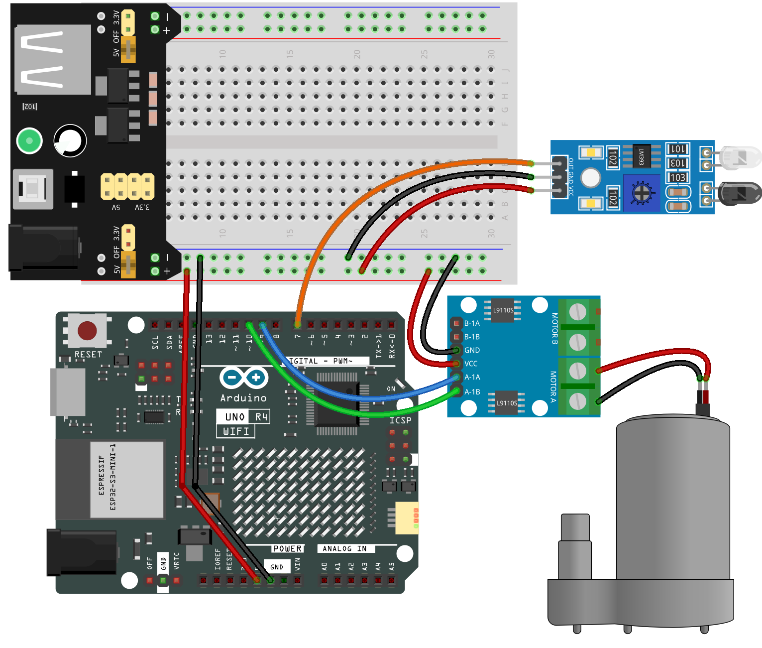

Wiring
../_images/Auto_soap_bb.png
Common Connections:
  • L9110 Motor Driver Module
    • VCC: Connect to breadboard’s red power bus.
    • A-1A: Connect to 9 on the Arduino.
    • A-1B: Connect to 10 on the Arduino.
  • IR Obstacle Avoidance Sensor Module
    • OUT: Connect to 7 on the Arduino.
  • Centrifugal Pump
    • Connect to L9110 Motor Driver Module MOTOR A.
