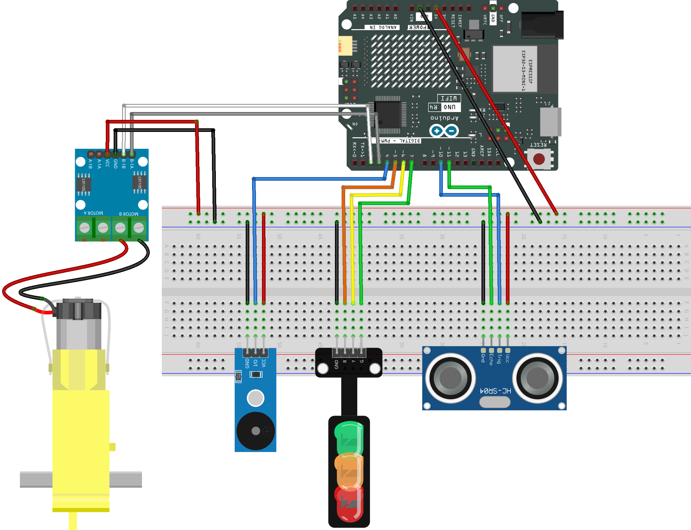

Wiring
../_images/Smart_Stop3.0_bb.png
Common Connections:
  • Ultrasonic Sensor Module
    • Trig: Connect to 10 on the Arduino.
    • Echo: Connect to 11 on the Arduino.
  • TT Motor
    • Connect to MOTOR B on the L9110 Motor Driver Module.
  • L9110 Motor Driver Module
    • B-1B: Connect to 2 on the Arduino.
    • B-1A: Connect to 3 on the Arduino.
  • Buzzer Module
    • I/0: Connect to 4 on the Arduino.
  • Traffic light LED
    • R: Connect to 5 on the Arduino.
    • Y: Connect to 6 on the Arduino.
    • G: Connect to 7 on the Arduino.
