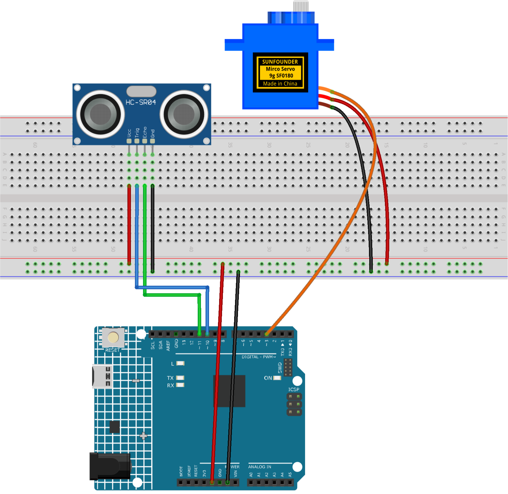

Wiring
../_images/RPS_Machine1.0_bb.png
Common Connections:
  • Digital Servo Motor
    • Connect to breadboard’s positive power bus.
    • Connect to breadboard’s negative power bus.
    • Connect to 3 on the Arduino.
  • Ultrasonic Sensor Module Front
    • Trig: Connect to 10 on the Arduino.
    • Echo: Connect to 11 on the Arduino.
    • VCC: Connect to breadboard’s red power bus.
