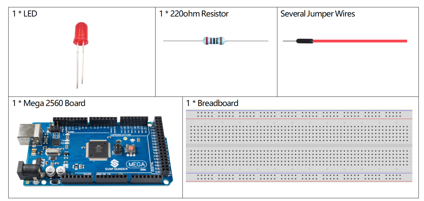

Componenti Necessari
../_images/list_1.11.png
