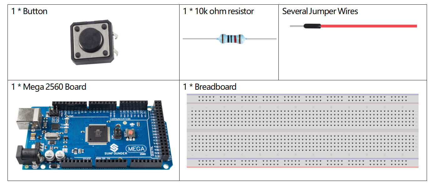

Composants Requis
../_images/list_2.15.png
