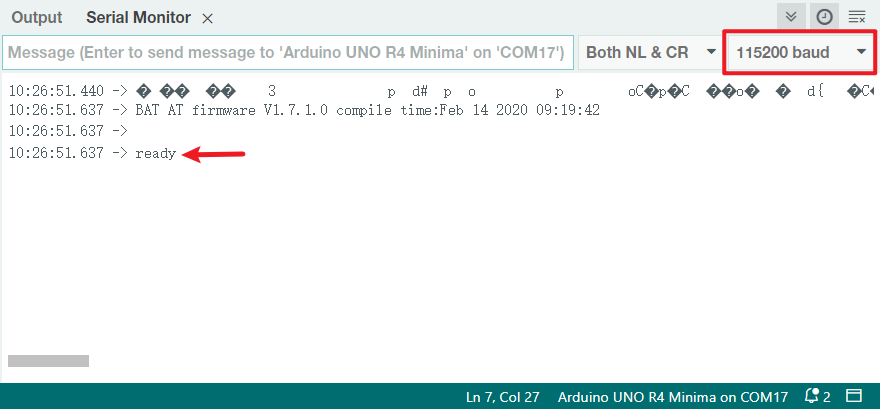

  3. Click the magnifying glass icon (Serial Monitor) in the upper right corner and set the baud rate to 115200. (You may have some printed information like me, or you may not, it doesn’t matter, just go to the next step.)
    ../../_images/esp01_configurie_1.png
    Warning
    • If ready doesn’t appear, you can try to reset the ESP8266 module(connect RST to GND) and re-open the Serial Monitor.

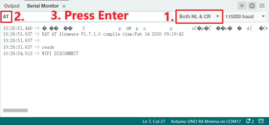

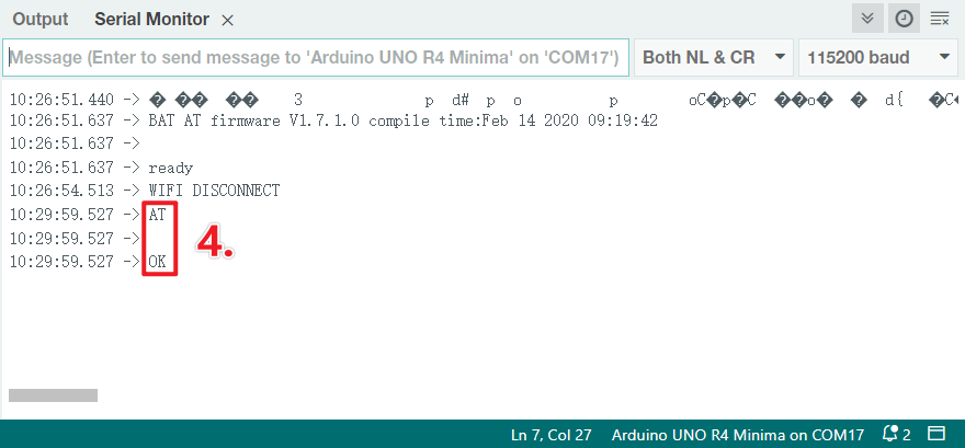

  4. Click on NEWLINE DROPDOWN BOX, select both NL & CR in the drop down option, enter AT, if it returns OK, it means ESP8266 has successfully established connection with R4 board.
    ../../_images/esp01_configurie_2.png ../../_images/esp01_configurie_3.png

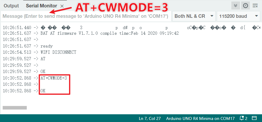

  5. Enter AT+CWMODE=3 and the managed mode will be changed to Station and AP coexistence.
    ../../_images/esp01_configurie_4.png
