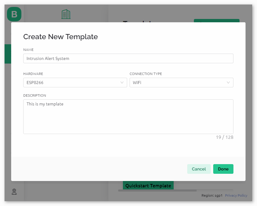

1 Create template
Firstly, we need to establish a template on Blynk. Follow the steps below to create a “Intrusion Alert System” template.

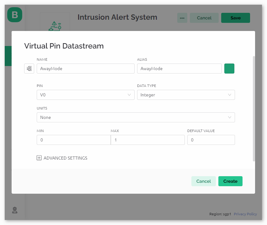

  • Create Virtual Pin V0 according to the following diagram:
    Set the name of the Virtual Pin V0 to AwayMode. Set the DATA TYPE to Integer and MIN and MAX to 0 and 1.

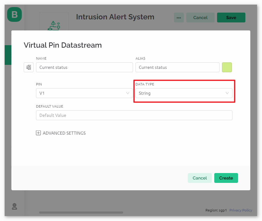

  • Create Virtual Pin V1 according to the following diagram:
    Set the name of the Virtual Pin V1 to Current status. Set the DATA TYPE to String.
    ../_images/02-datastream_2_shadow.png

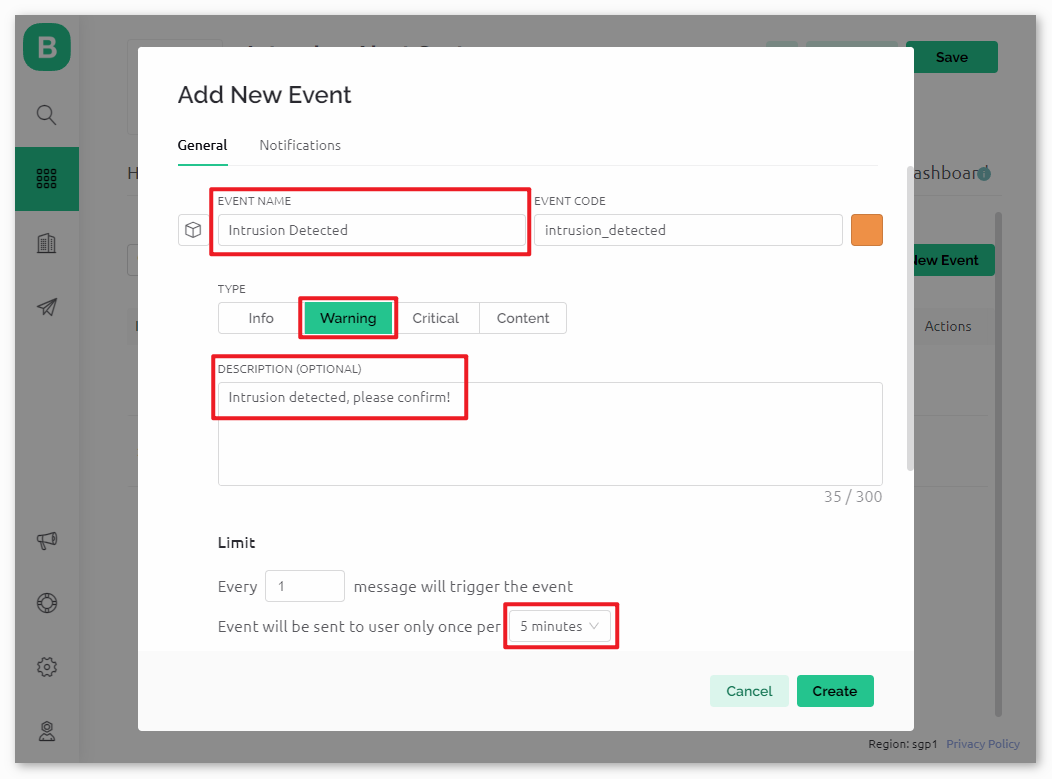

3 Event
Next, we will create an event that logs the detection of intrusion and sends an email notification.
It is recommended to keep it consistent with my settings, otherwise you may need to modify the code to run the project. Make sure that the EVENT CODE is set as intrusion_detected.
../_images/02-event_1_shadow.png

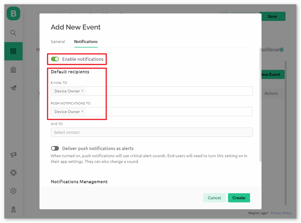

Go to the Notifications page and configure email settings.
../_images/02-event_2_shadow.png

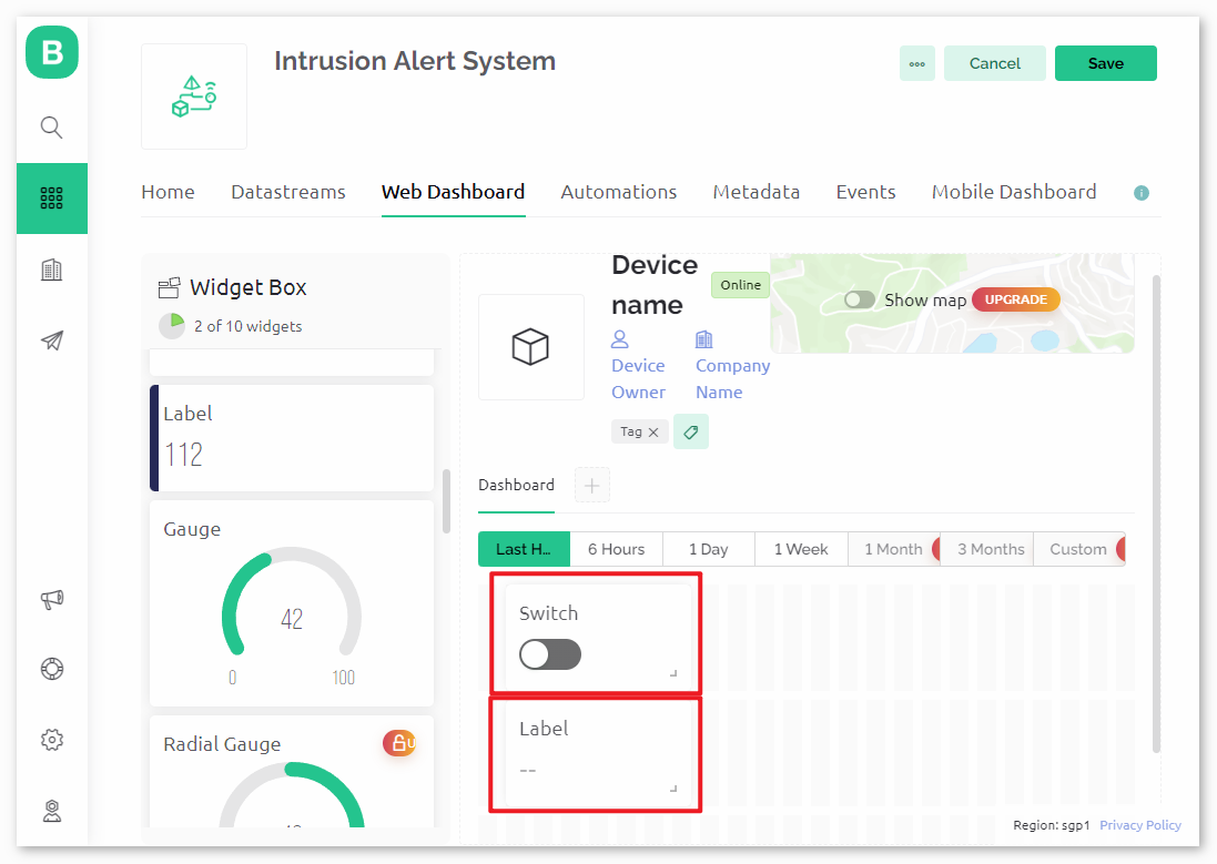

Drag and drop a Switch widget and a Label widget to the Web Dashboard page.
../_images/02-web_dashboard_1_shadow.png

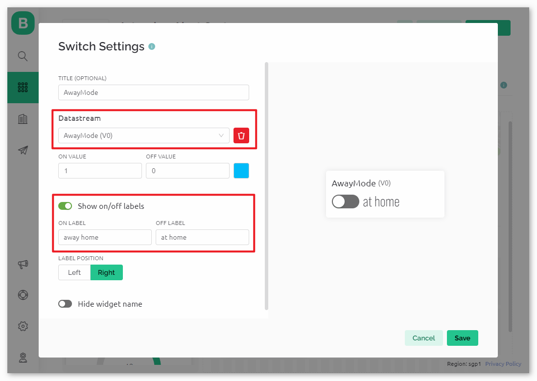

In the settings page of the Switch widget, select Datastream as AwayMode(V0). Set ONLABEL and OFFLABEL to display “away home” when the switch is turned on, and “at home” when the switch is turned off.
../_images/02-web_dashboard_2_shadow.png

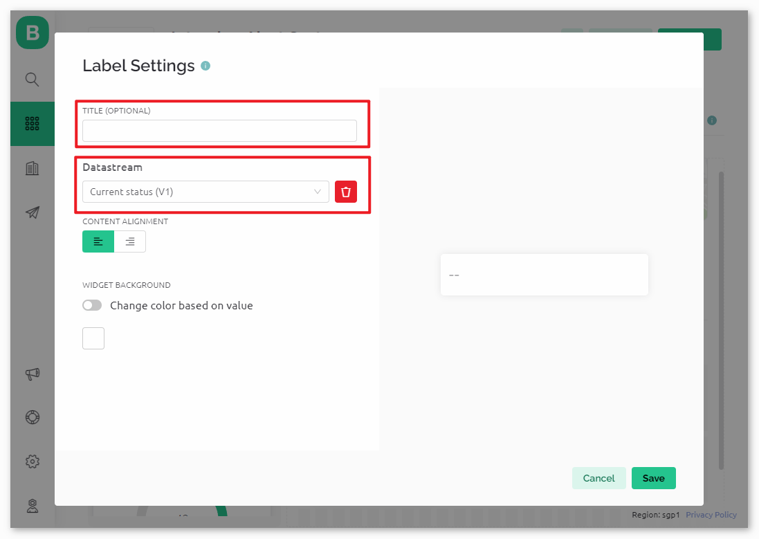

In the settings page of the Label widget, select Datastream as Current status(V1).
../_images/02-web_dashboard_3_shadow.png

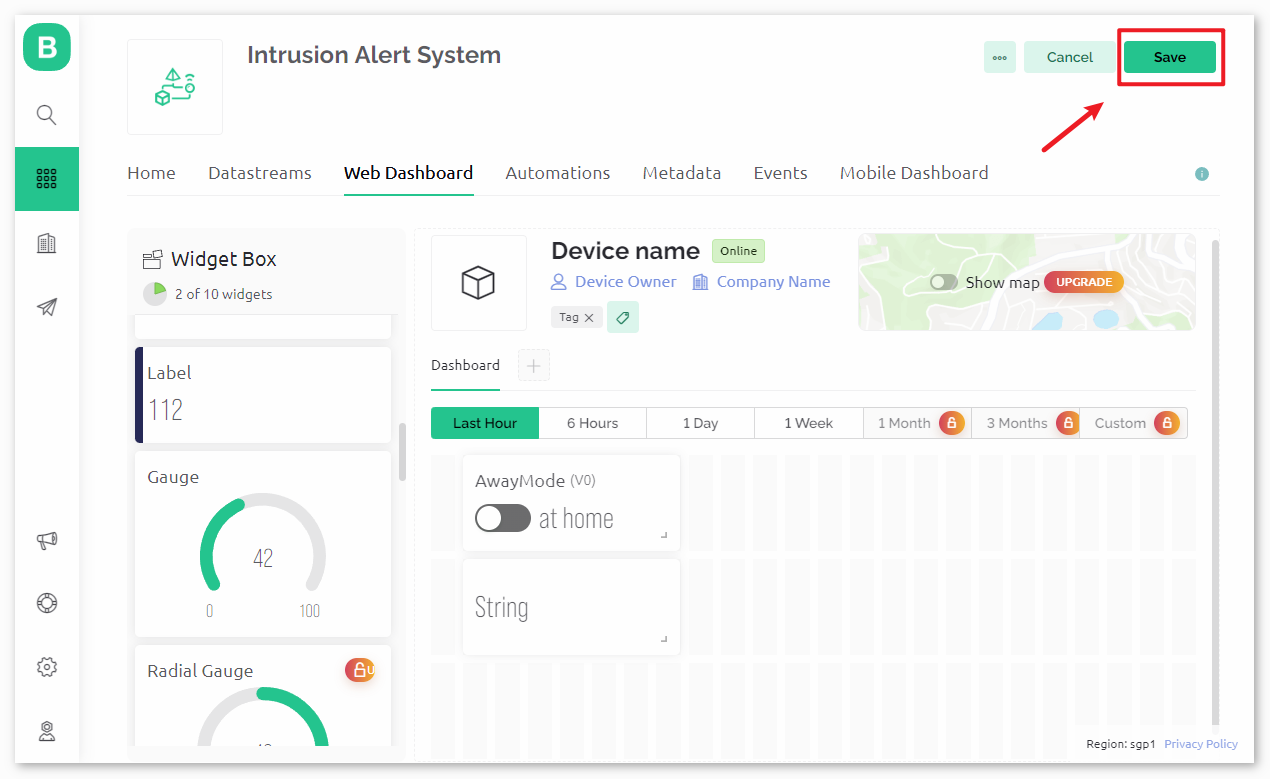

5 Save template
At last, remember to save the template.

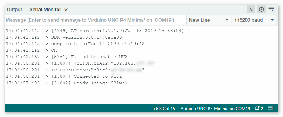

  5. Open the Serial monitor(set baudrate to 115200) and wait for a prompt such as a successful connection to appear.
    ../_images/02-ready_1_shadow.png
