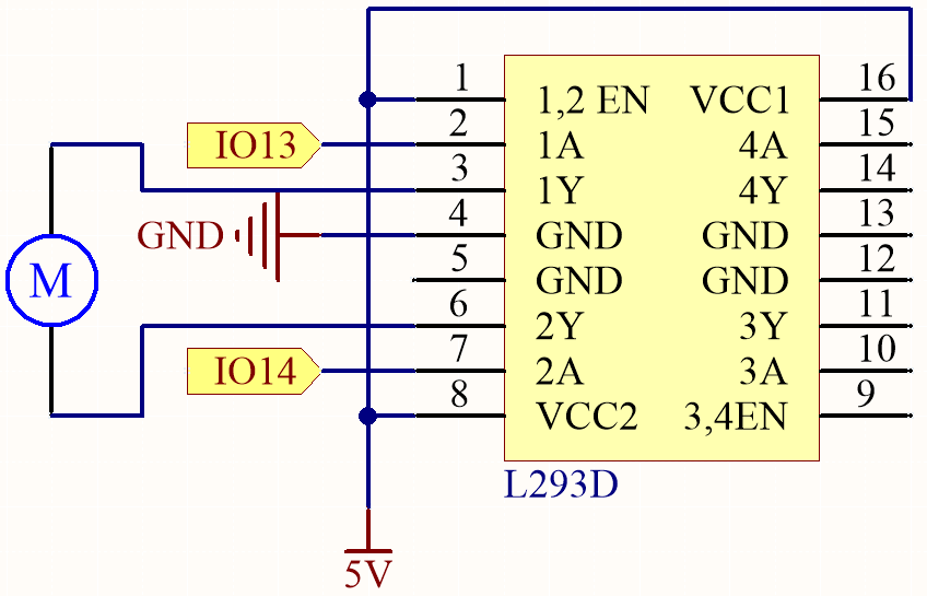

Schéma
../../_images/circuit_4.1_motor_l293d.png
