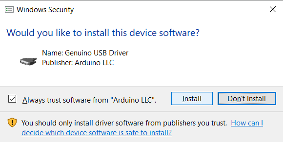

  2. In addition, your firewall or security center may pop up a few times asking you if you want to install some device driver. Please install all of them.
