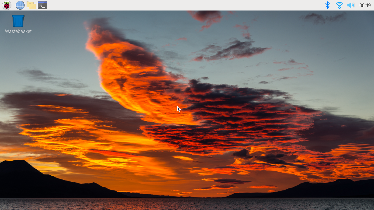

  4. Now you can see the desktop of the Raspberry Pi.
    ../../_images/windows_09.png
