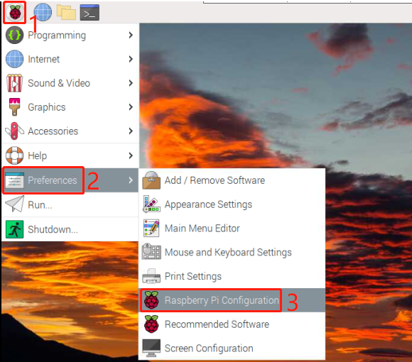

  1. Connect a monitor (or TV), mouse and keyboard to the Raspberry Pi and power it on. Select the menu according to the numbers in the figure.
    ../../_images/mac_01.png

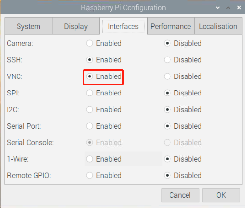

  2. The following screen will be displayed. Set VNC to Enabled on the Interfaces tab, and click OK.
    ../../_images/mac_02.png

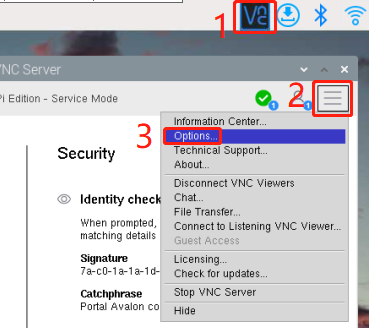

  4. Open the VNC server window by clicking on the VNC icon, then click on the Menu button in the top right corner and select Options.
    ../../_images/mac_04.png

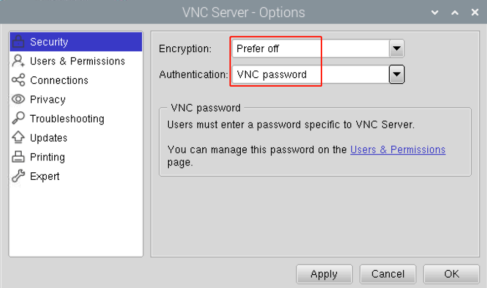

  5. You will be presented with the following screen where you can change the options.
    ../../_images/mac_05.png
    Set Encryption to Prefer off and Authentication to VNC password.

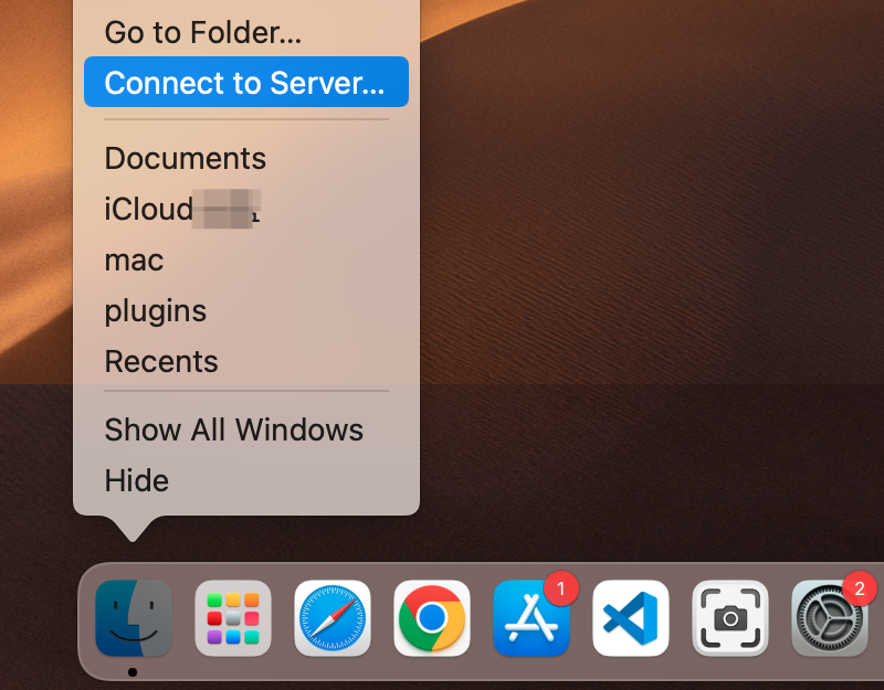

  1. Now, select Connect to Server from the Finder’s menu, which you can open by right-clicking.
    ../../_images/mac_07.png

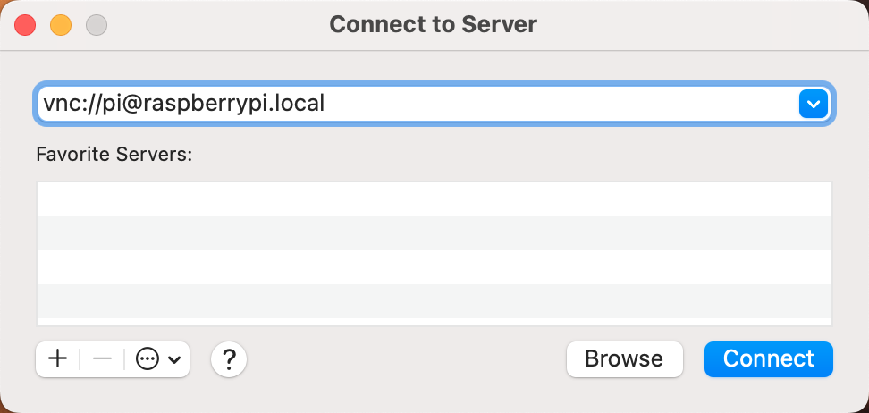

  2. Type in vnc://<username>@<hostname>.local (or vnc://<username>@<IP address>). After entering, click Connect.
    ../../_images/mac_08.png

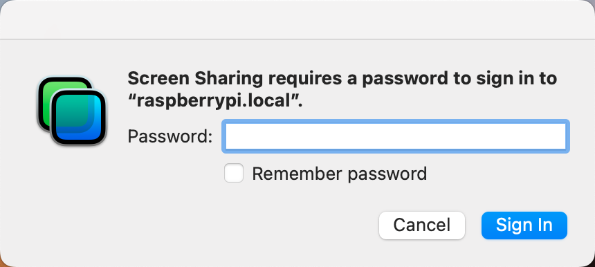

  3. You will be asked for a password, so please enter it.
    ../../_images/mac_09.png

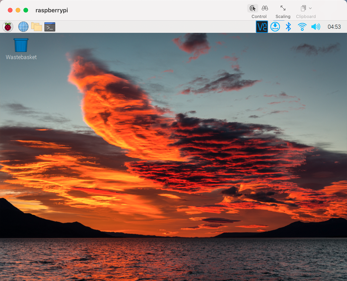

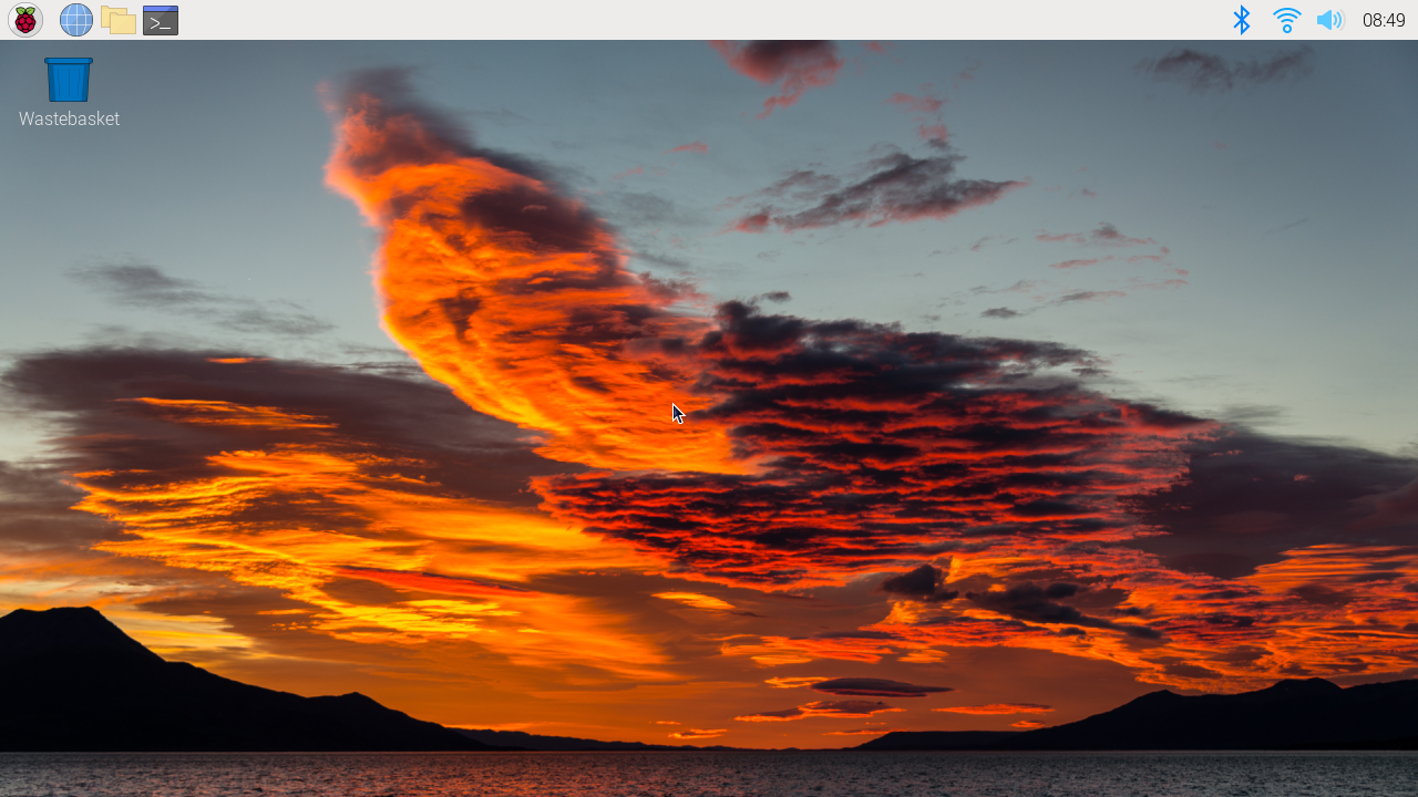

  4. The desktop of the Raspberry pi will be displayed, and you will be able to operate it from the Mac as it is.
    ../../_images/mac_10.png

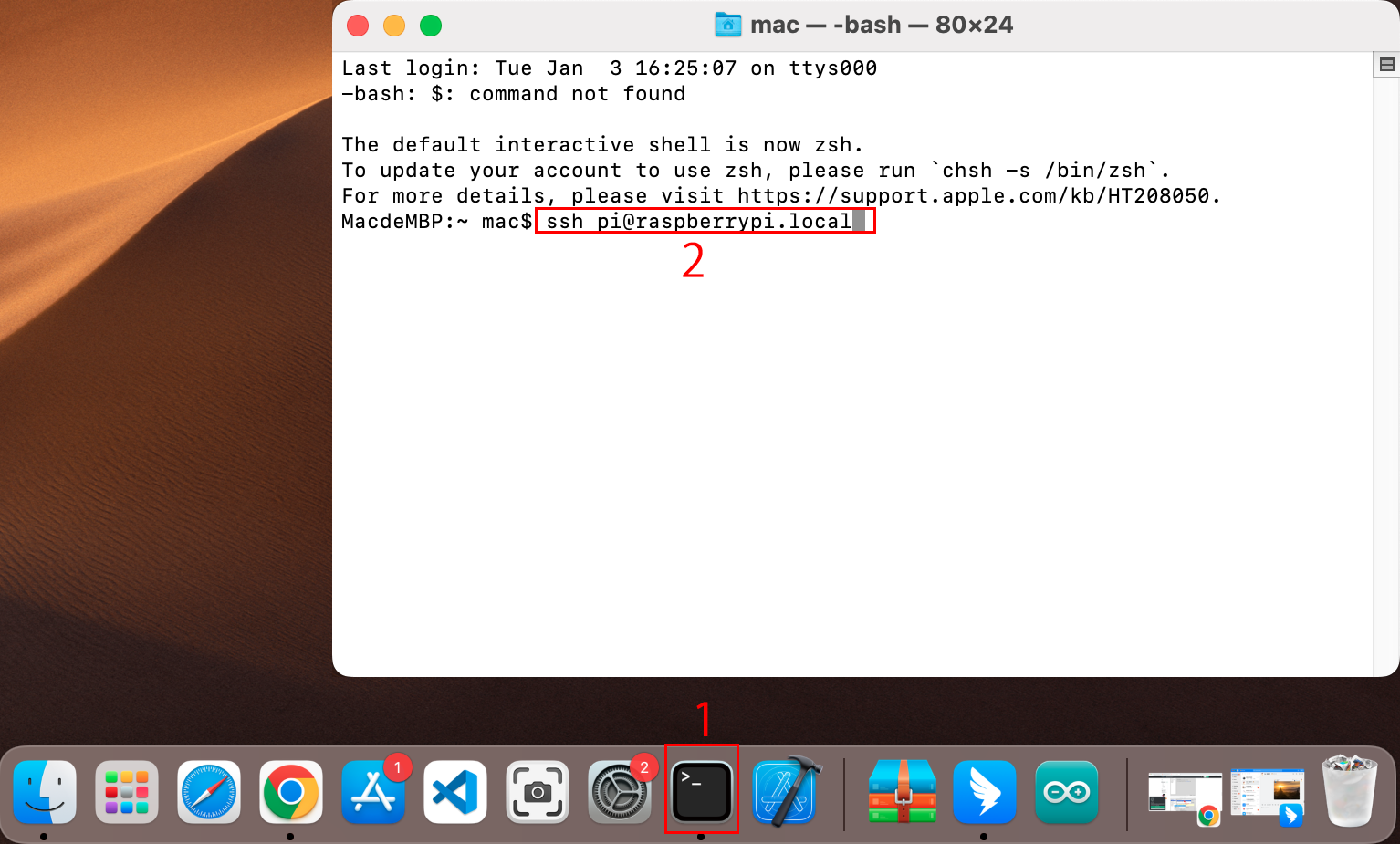

  1. Type ssh <username>@<hostname>.local to connect to the Raspberry Pi.
    ssh pi@raspberrypi.local
    ../../_images/mac_11.png

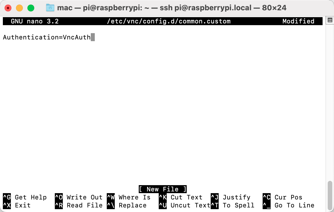

    To specify parameters for all programs for all user accounts on the computer, create /etc/vnc/config.d/common.custom.
    sudo nano /etc/vnc/config.d/common.custom
    After entering Authentication=VncAuthenter, press Ctrl+X -> Y -> Enter to save and exit.

  12. Now, select Connect to Server from the Finder’s menu, which you can open by right-clicking.
    ../../_images/mac_16.png
  13. Type in vnc://<username>@<hostname>.local (or vnc://<username>@<IP address>). After entering, click Connect.
    ../../_images/mac_17.png
  14. You will be asked for a password, so please enter it.
    ../../_images/mac_18.png
  15. The desktop of the Raspberry pi will be displayed, and you will be able to operate it from the Mac as it is.
    ../../_images/mac_19.png
