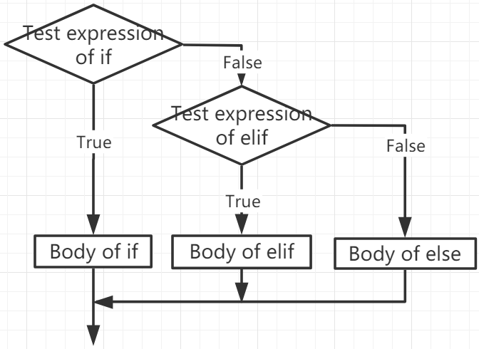

Diagrama de flujo de la declaración if…elif…else
../../../_images/if_elif_else.png
Ejemplo
x = 10
y = 9
if x > y:
    print("x is greater than y")
elif x == y:
    print("x and y are equal")
else:
>>> %Run -c $EDITOR_CONTENT
x is greater than y
