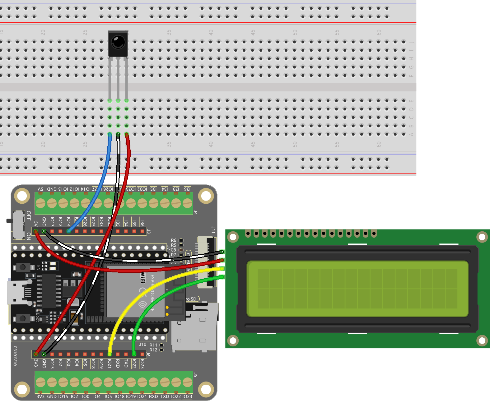

Verdrahtung
../../_images/6.7_guess_receiver_bb.png
