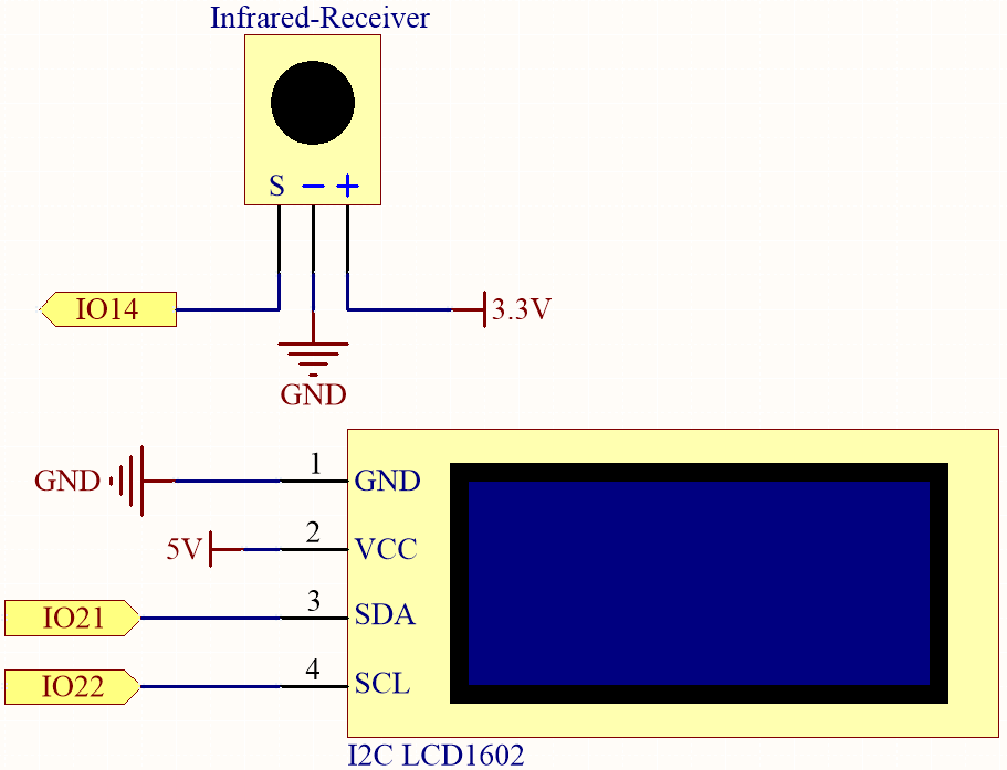

Esquemático
../../_images/circuit_6.7_guess_number.png
