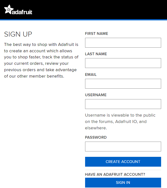

  2. Fill out the form to create an account.
    ../_images/sp230516_102629.png

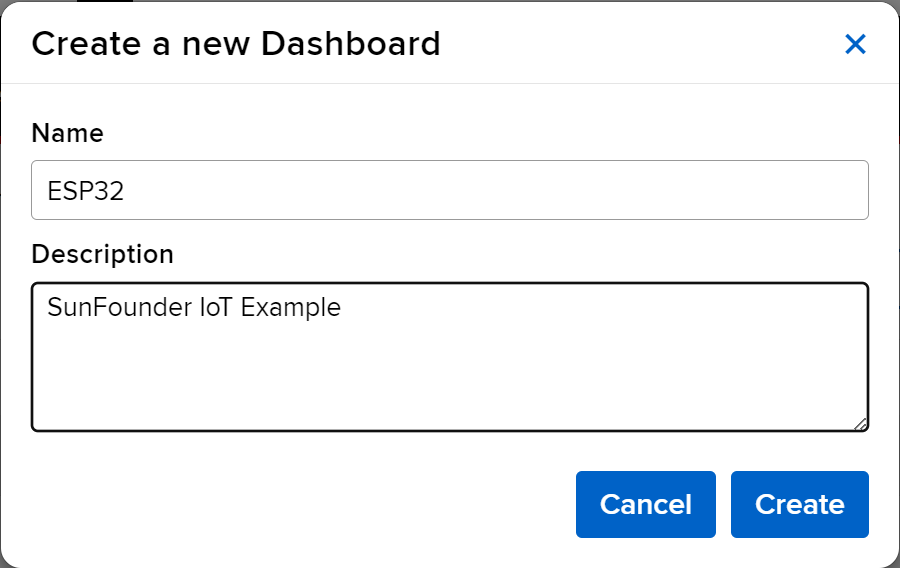

  4. Create a New Dashboard.
    ../_images/sp230516_103744.png

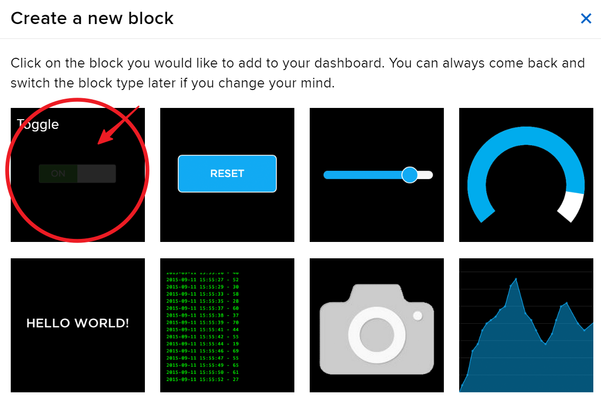

  6. Create 1 Toggle block.
    ../_images/sp230516_105727.png

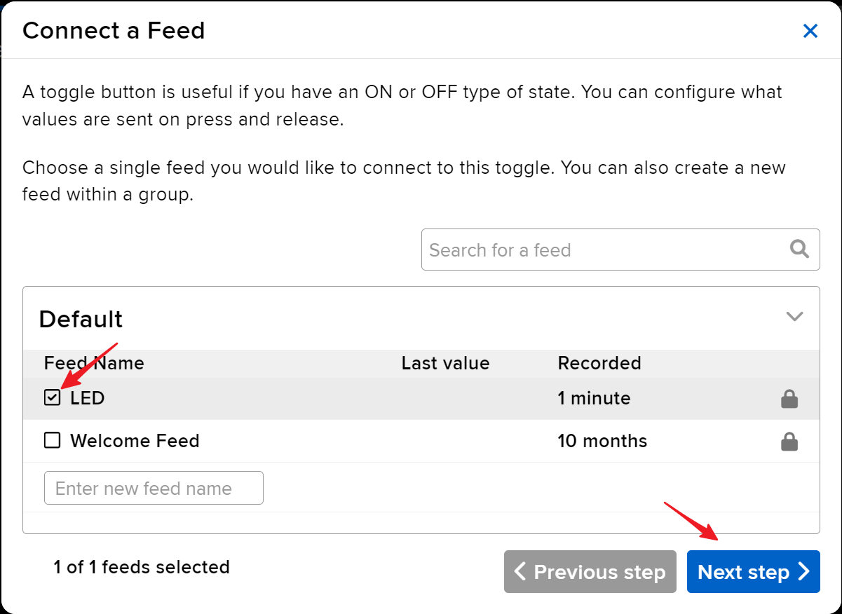

  7. Next, you’ll need to create a new feed here. This toggle will be used to control the LED, and we’ll name this feed “LED”.
    ../_images/sp230516_105641.png
  8. Check the LED feed, then move to the next step.
    ../_images/sp230516_105925.png

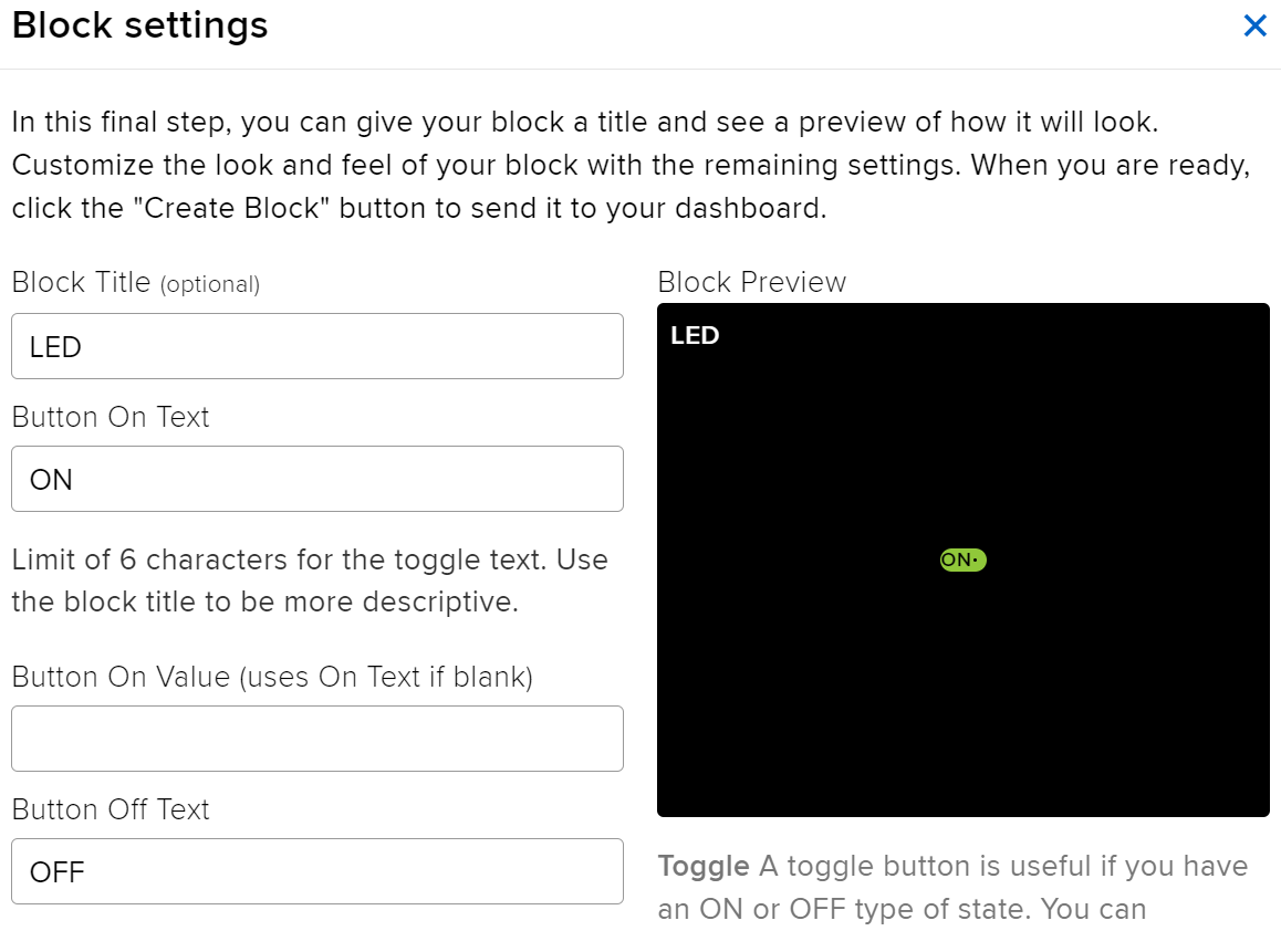

  9. Complete the block settings (mainly Block Title, On Text, and Off Text), then click on the Create block button at the bottom right to finish.
    ../_images/sp230516_110124.png

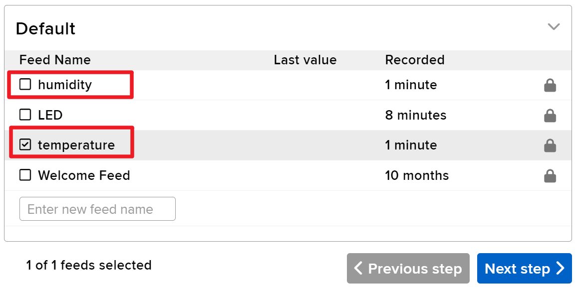

  10. We also need to create two Text Blocks next. They will be used to display temperature and humidity. So, create two feeds named temperature and humidity.
    ../_images/sp230516_110657.png

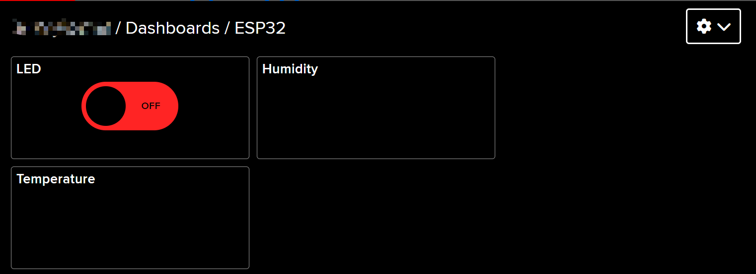

  11. After creation, your Dashboard should look something like this:
    ../_images/sp230516_111134.png

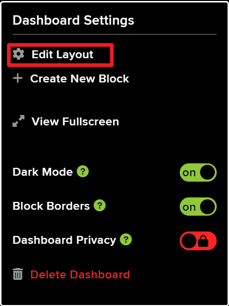

  12. You can adjust the layout by using the Edit Layout option on the Dashboard.
    ../_images/sp230516_111240.png

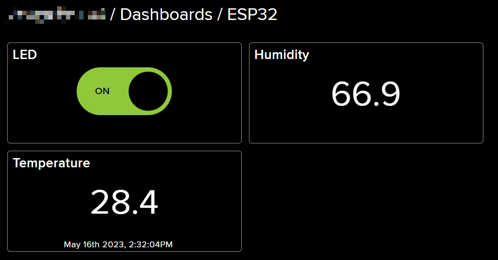

  8. Navigate back to Adafruit IO. Now you can observe the temperature and humidity readings on the dashboard, or utilize the LED toggle switch to control the on/off state of the external LED connected to the circuit.
    ../_images/sp230516_143220.png
