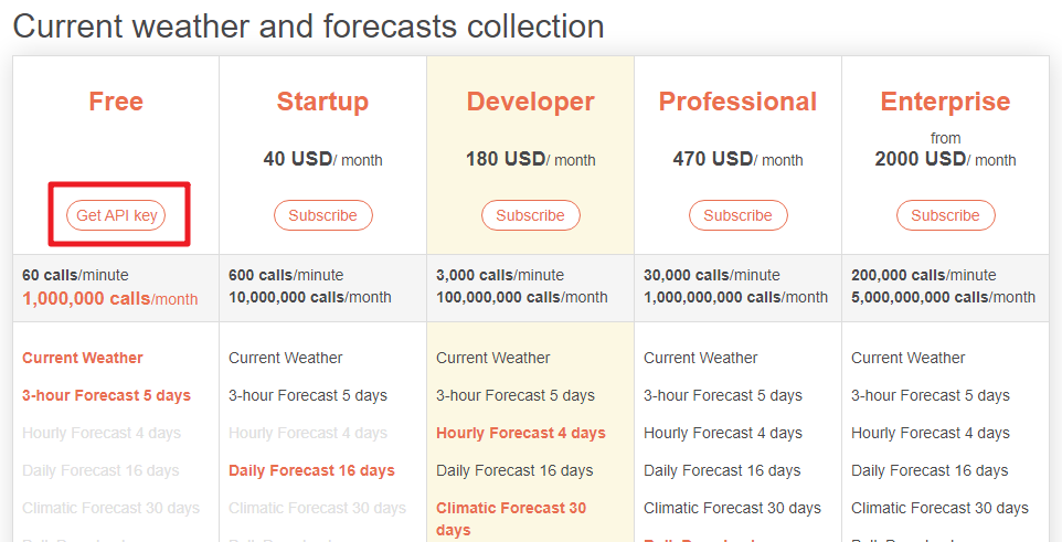

  4. Under Current weather and forecasts collection , subscribe to the appropriate service. In our project, Free is good enough.
    ../_images/OWM-4.png

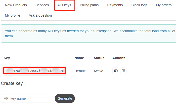

  5. Copy the Key from the API keys page.
    ../_images/OWM-5.png
