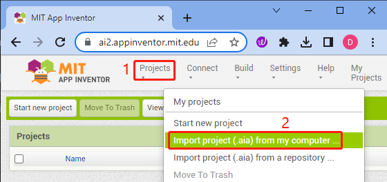

  1. Here is the login page: http://ai2.appinventor.mit.edu. You will require a Google account to register with MIT App Inventor.
  2. After logging in, navigate to Projects -> Import project (.aia) from my computer. Subsequently, upload the control_rgb_led.aia file located in the path esp32-starter-kit-main\c\codes\iot_10_bluetooth_app_inventor.
    ../_images/10_ble_app_inventor1.png
