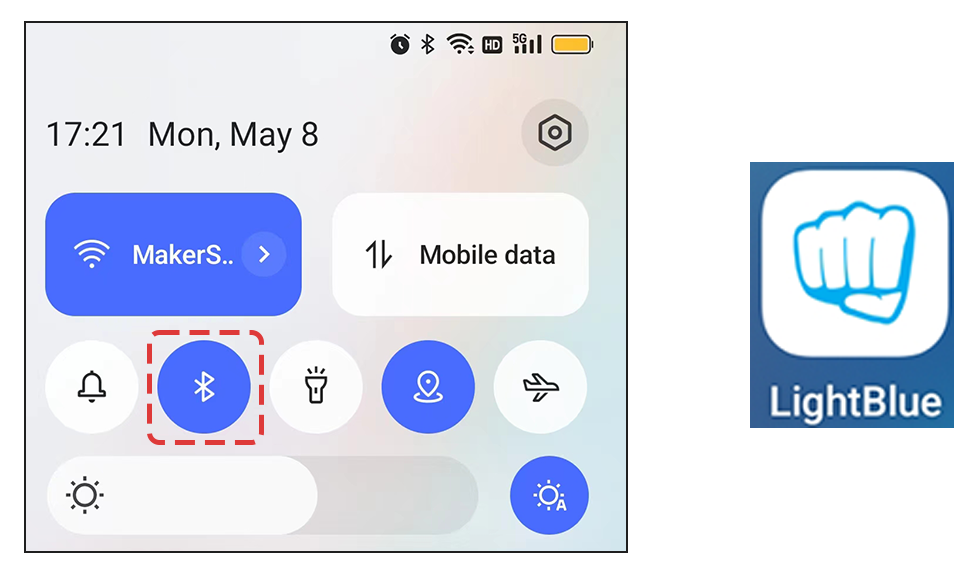

  5. After the code has been successfully uploaded, turn on Bluetooth on your mobile device and open the LightBlue app.

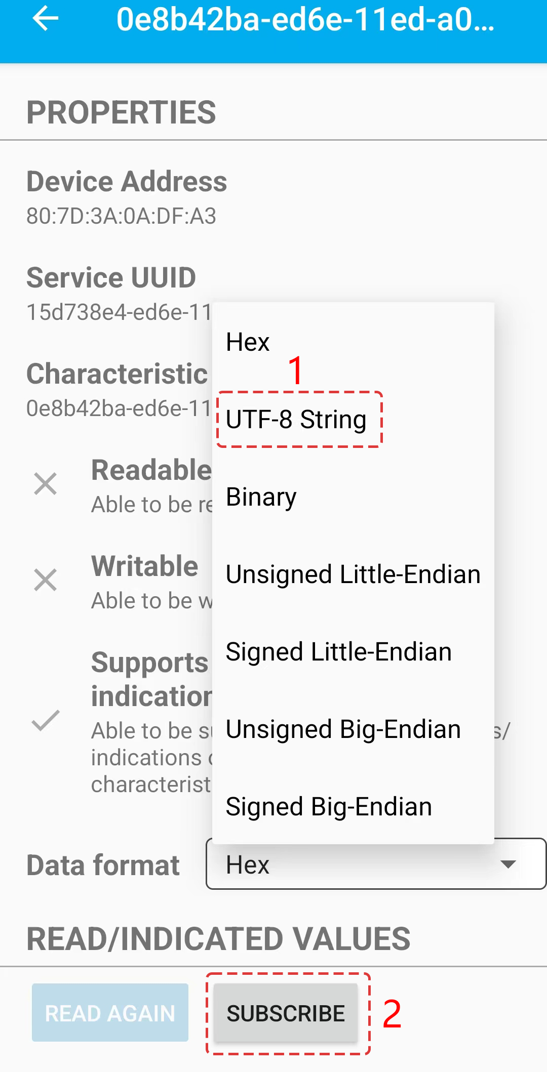

  7. Click the Receive UUID. Select the appropriate data format in the box to the right of Data Format, such as “HEX” for hexadecimal, “UTF-8 String” for character, or “Binary” for binary, etc. Then click SUBSCRIBE.

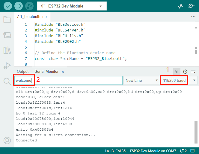

  8. Go back to the Arduino IDE, open the Serial Monitor, set the baud rate to 115200, then type “welcome” and press Enter.

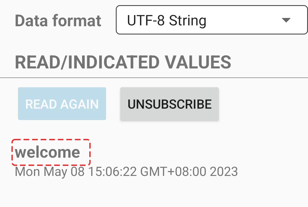

  9. You should now see the “welcome” message in the LightBlue app.

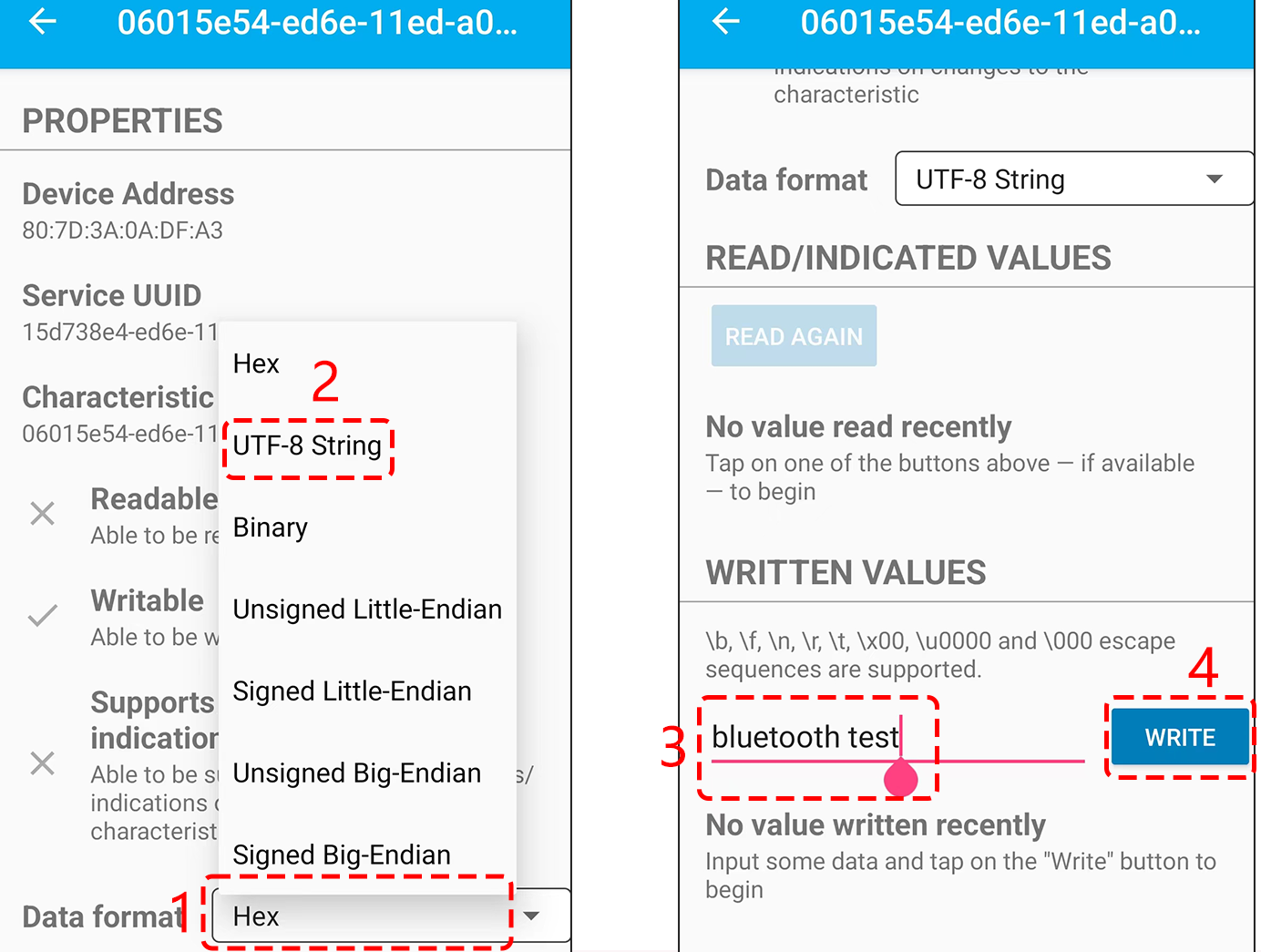

  10. To send information from the mobile device to the Serial Monitor, click the Send UUID, set the data format to “UTF-8 String”, and write a message.
    ../_images/bluetooth_send.png

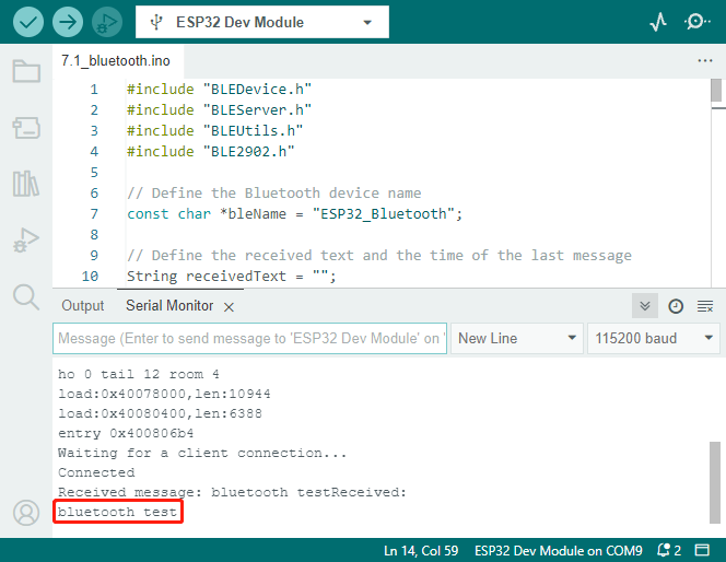

  11. You should see the message in the Serial Monitor.
