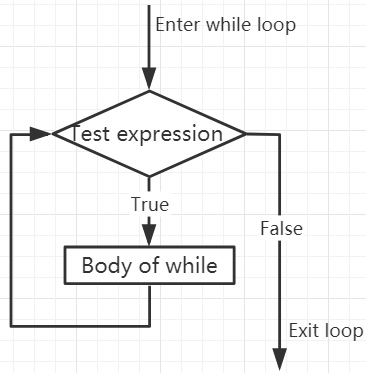

In the while loop, first check the test expression. Only when test expression evaluates to True, enter the body of the while. After one iteration, check the test expression again. This process continues until test expression evaluates to False.
In MicroPython, the body of the while loop is determined by indentation.
The body starts with an indentation and ends with the first unindented line.
Python interprets any non-zero value as True. None and 0 are interpreted as False.
while Loop Flowchart
