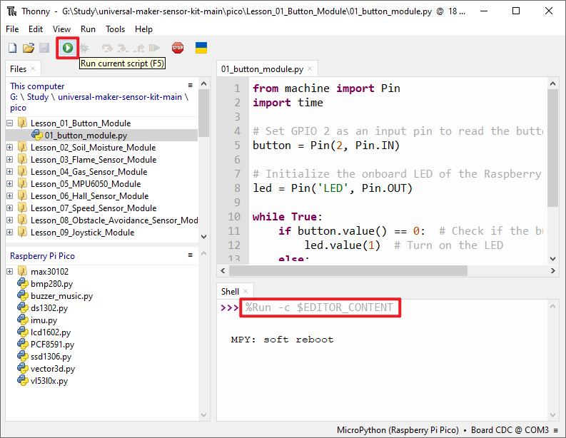

  3. Run the code
    To run the script, click the Run current script button or press F5.
    ../../_images/05_run_it.png
    If the code contains any information that needs to be printed, it will appear in the Shell; otherwise, only the following information will appear.
    >>> %Run -c $EDITOR_CONTENT
    Click View -> Shell to open the Shell window if it doesn’t appear on your Thonny.
    • %Run -c $EDITOR_CONTENT is a command from Thonny telling the MicroPython interpreter on your Pico W to run the contents of the script area - “EDITOR_CONTENT”.
    • If there is any message after that, it is usually the message that you tell MicroPython to print, or an error message for the code.

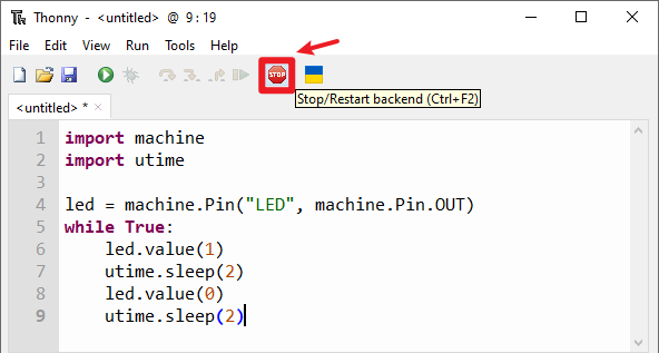

  5. Stop running
    To stop the code, click the Stop/Restart backend button.
    ../../_images/05_2_stop_it.png
