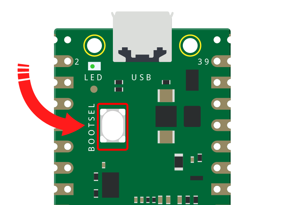

  2. Press and hold the BOOTSEL button and then connect the Pico to computer via a Micro USB cable. Release the BOOTSEL button after your Pico is mount as a Mass Storage Device called RPI-RP2.
    ../../_images/bootsel_onboard.png

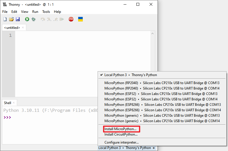

  3. In the bottom right corner, click the interpreter selection button and select Install Micropython.
    If your Thonny does not have this option, please update to the latest version.
    ../../_images/set_pico2.png
