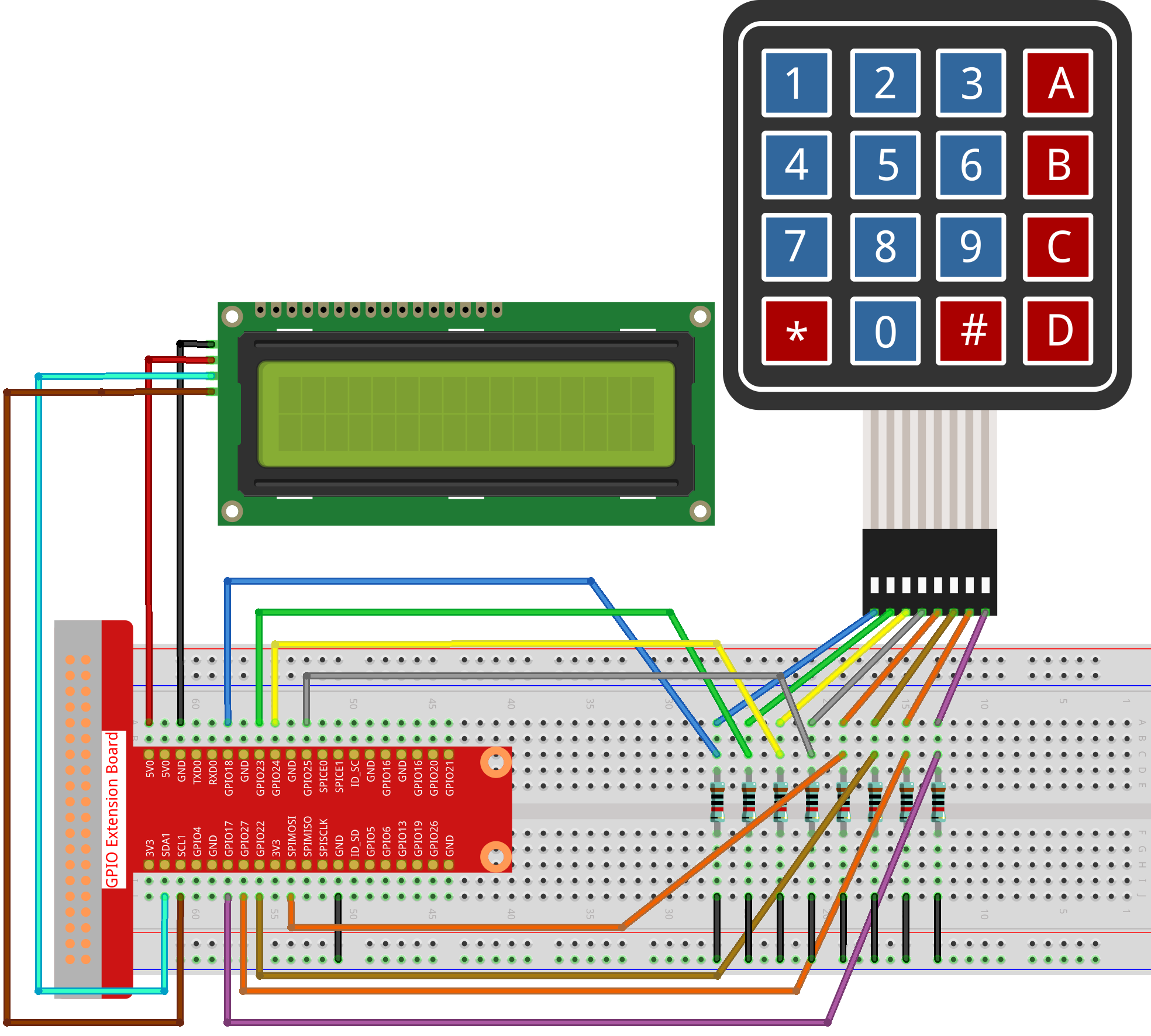

Schema Elettrico
Pin 16
Pin 18
GPIO25
Pin 22
25
Pin 19
SDA1
Pin 3
SCL1
Pin 5
../_images/Schematic_three_one9.png

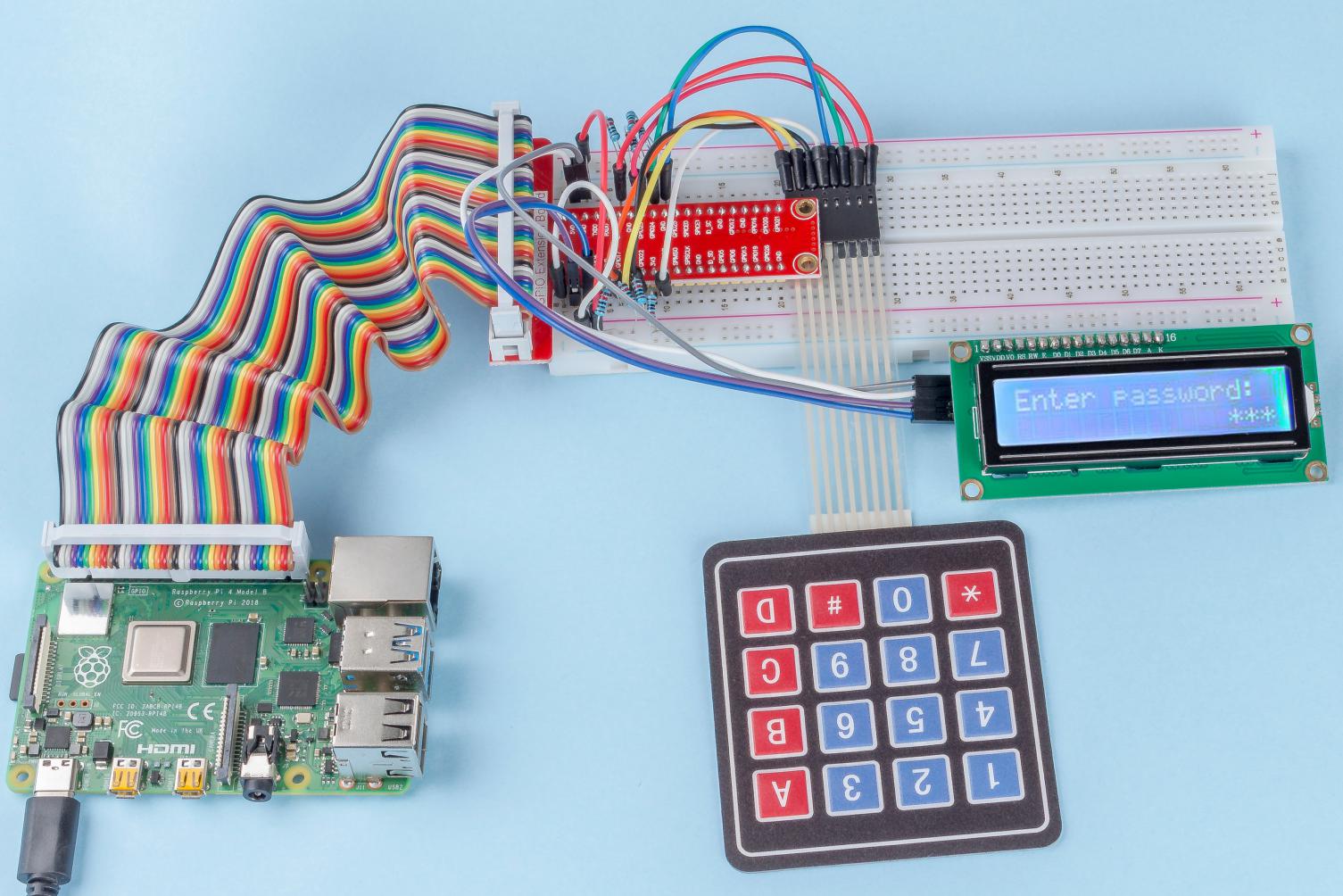

Foto del Fenomeno
../_images/image263.jpeg
