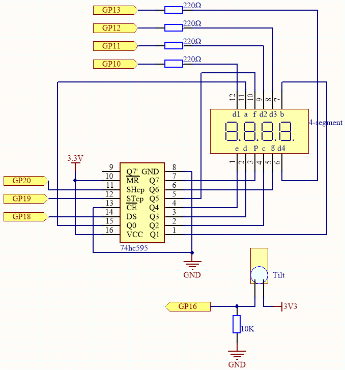

sch_10_second

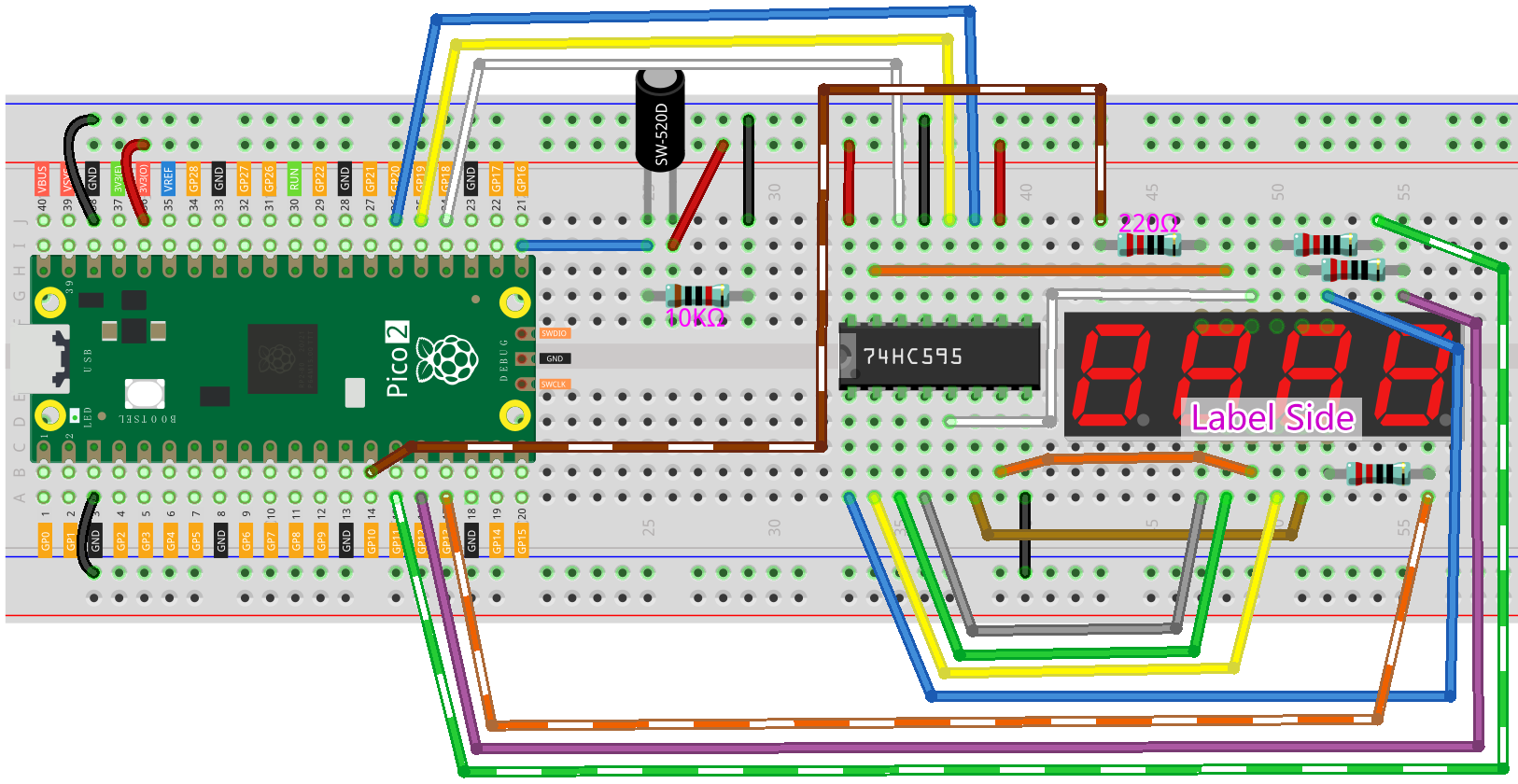

Verdrahtungsplan
wiring_game_10_second
