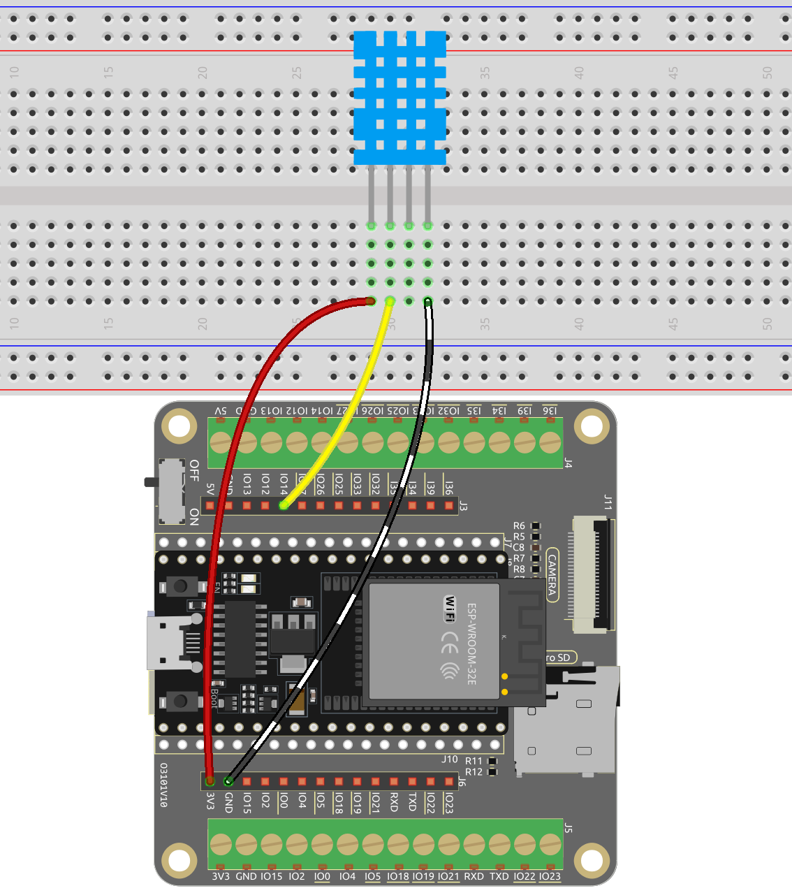

Cableado

, que proporciona funciones para interactuar con los sensores DHT. Luego, establece el pin y tipo para el sensor DHT.#include "DHT.h" #define DHTPIN 14 // Set the pin connected to the DHT11 data pin #define DHTTYPE DHT11 // DHT 11 DHT dht(DHTPIN, DHTTYPE);
Inicializa la comunicación serial a una tasa de baudios de 115200 e inicializa el sensor DHT.
void setup() { Serial.begin(115200); Serial.println("DHT11 test!"); dht.begin(); }
En la función
loop()
, lee los valores de temperatura y humedad del sensor DHT11 e imprímelos en el monitor serial.void loop() { // Wait a few seconds between measurements. delay(2000); // Reading temperature or humidity takes about 250 milliseconds! // Sensor readings may also be up to 2 seconds 'old' (it's a very slow sensor) float humidity = dht.readHumidity(); // Read temperature as Celsius (the default) float temperture = dht.readTemperature(); // Check if any reads failed and exit early (to try again). if (isnan(humidity) || isnan(temperture)) { Serial.println("Failed to read from DHT sensor!"); return; } // Print the humidity and temperature Serial.print("Humidity: "); Serial.print(humidity); Serial.print(" %\t"); Serial.print("Temperature: "); Serial.print(temperture); Serial.println(" *C"); }
