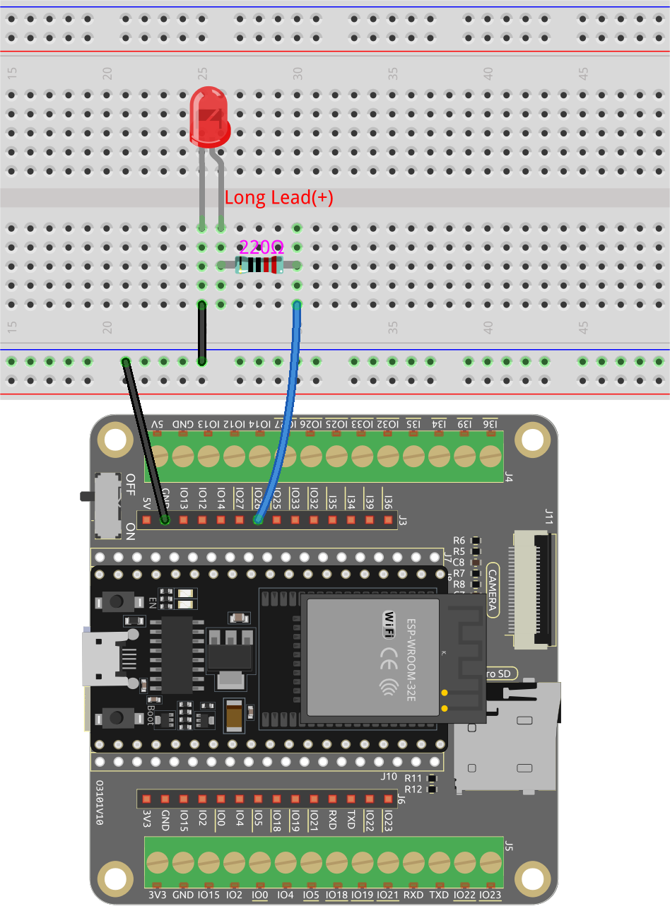

Also build a simple circuit to make this LED blink in 2 different modes.
../../_images/1_hello_led_bb.png

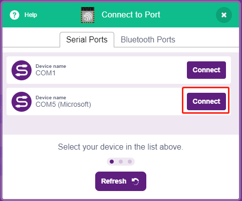

A connection window will then pop up for you to select the port to connect to, and return to the home page when the connection is complete. If you break the connection during use, you can also click Connect to reconnect.
Si aparece COM1 o ningún puerto, es posible que tu computadora no reconozca la placa. Consulta Installation manuelle du pilote pour ESP32.
../../_images/1_connect.png

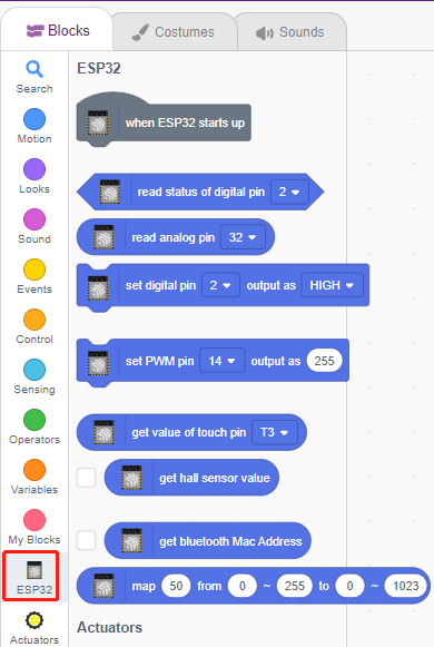

At the same time, ESP32 related palettes, such as ESP32, Actuators, etc., will appear in the Block Palette.
../../_images/1_arduino_uno.png

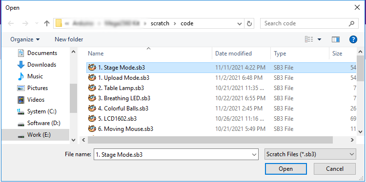

Of course, you can open the scripts directly to run them, but please download them from github first.
You can click on File in the top right corner and then choose Open.
../../_images/0_open.png
Choose Open from Computer.
../../_images/0_dic.png
Then go to the path of esp32-starter-kit-main\scratch, and open 1. Stage Mode.sb3. Please ensure that you have downloaded the required code from github.
../../_images/0_stage.png
Click directly on the script to run it, some projects are click on the green flag or click on the sprite.

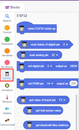

Click on the ESP32 palette.
The LED is controlled by the digital pin 26 (only 2 states, HIGH or LOW), so drag the [set digital pin out as] block to the script area.
Since the default state of the LED is lit, now set pin 23 to LOW and click on this block and you will see the LED go off.
  • [set digital pin out as]: Set the digital pin to (HIGH/LOW) level.
../../_images/1_digital.png

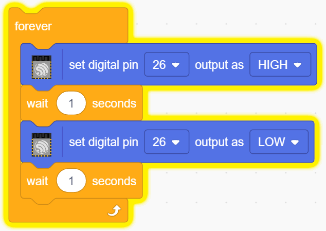

In order to see the effect of continuous blinking LED, you need to use the [Wait 1 seconds] and [forever] blocks in the Control palette. Click on these blocks after writing, there is a yellow halo means it is running.
  • [Wait 1 seconds]: from the Control palette, used to set the time interval between 2 blocks.
  • [forever]: from the Control palette, allows the script to keep running unless manually paused.
../../_images/1_more.png

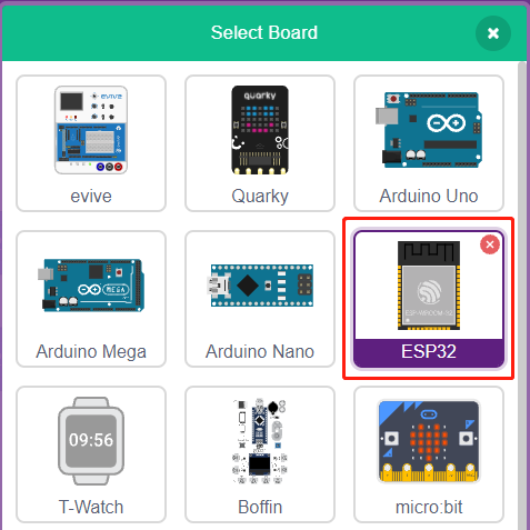

Open PictoBlox and click Board in the top right navigation bar to select the board.
../../_images/1_board.png
For example, choose ESP32.
../../_images/1_choose_uno.png

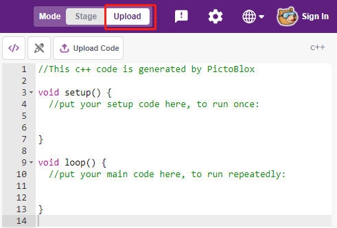

After selecting Upload mode, the stage will switch to the original code area.
../../_images/1_upload.png

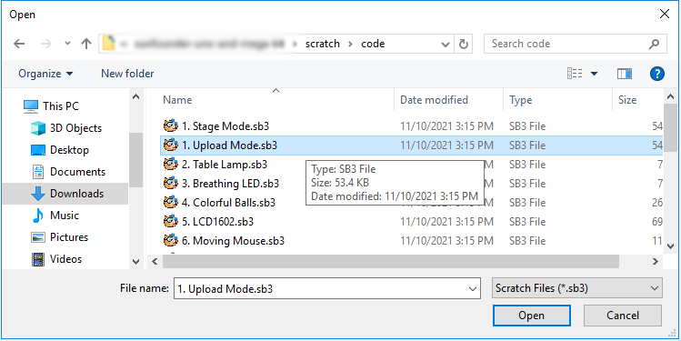

You can click on File in the top right corner.
Then go to the path of esp32-starter-kit-main\scratch, and open 1. Upload Mode.sb3. Please ensure that you have downloaded the required code from github.
../../_images/0_upload.png
Finally, click the Upload Code button.

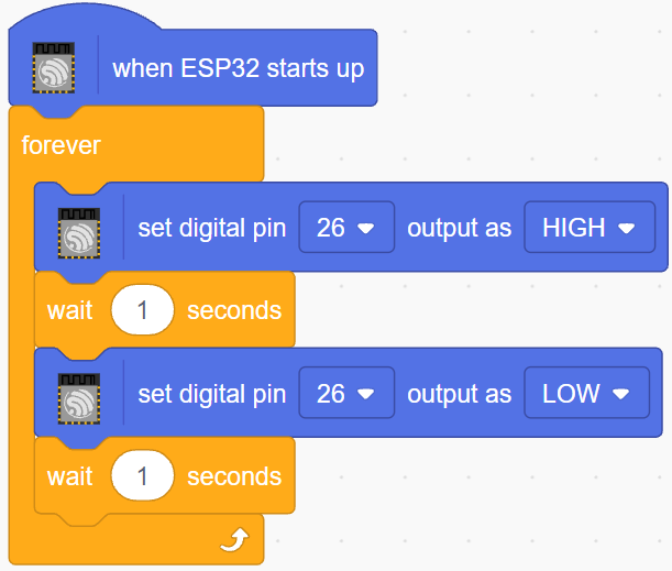

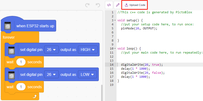

Drag [when ESP32 starts up] to the script area, which is required for every script.
../../_images/1_uno_starts.png

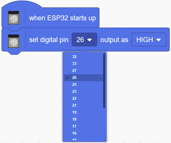

The LED is controlled by the digital pin26 (only 2 states HIGH or LOW), so drag the [set digital pin out as] block to the script area.
Since the default state of the LED is lit, now set pin26 to LOW and click on this block and you will see the LED go off.
../../_images/1_upload_digital.png

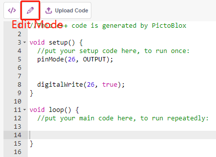

At this point you will see the code appear on the right side, if you want to edit this code, then you can turn Edit mode on.
../../_images/1_upload1.png
  • [forever]: from the Control palette, allows the script to keep running unless the power is off.
../../_images/1_upload_more.png
