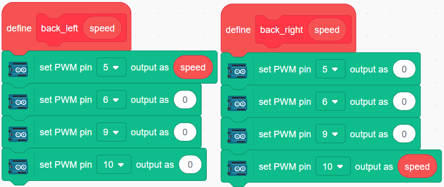

Make the car to go backward to the left and backward to the right.
../../_images/7_avoid2_2.png
