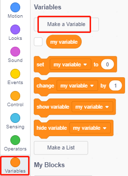

2. Creating a variable.
Create a variable called pwm to store the value of the pwm change.
Click on the Variables palette and select Make a Variable.
