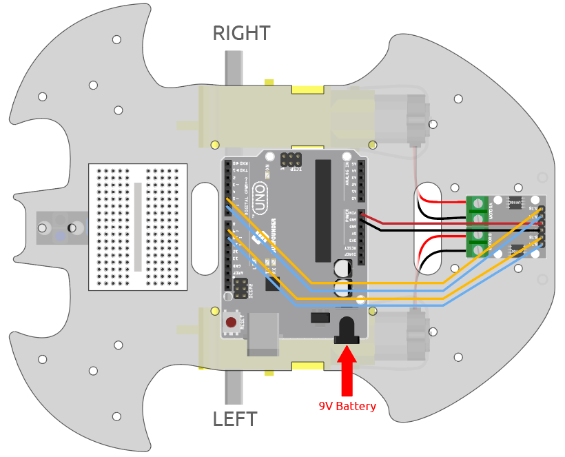

The L9110 motor driver module is a high power motor driver module for driving DC and stepper motors. The L9110 module can control up to 4 DC motors, or 2 DC motors with direction and speed control.
Connect the wires between the L9110 module and the R3 board according to the diagram below.
L9110 Module
R3 Board
Motor
A-1B
A-1A
B-1B(B-2A)
9
B-1A
10
OB(B)
Black wire of right motor
OA(B)
Red wire of right motor
OB(A)
Black wire of left motor
OA(A)
Red wire of left motor

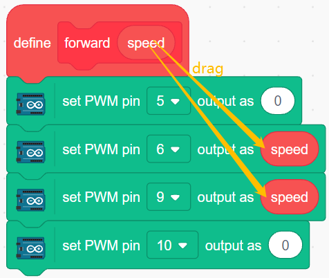

Enter the name of the block - forward and check Add an input, set the input name to speed.
../../_images/1_test32.png
Drag and drop the blocks that control the cars forward into forward, note that you need to add the parameter - speed to pin6 and pin9.
../../_images/1_test33.png

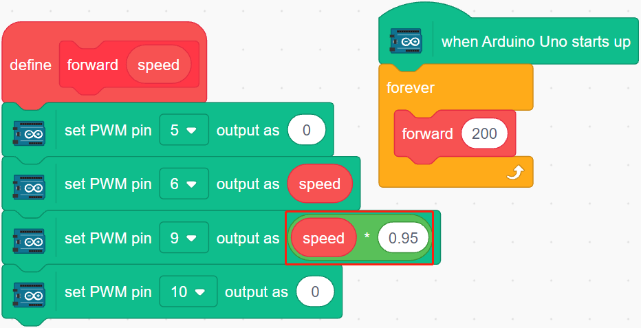

Call the created block in the [Forward] block - forward. In Upload mode, the [When Arduino Uno starts up] block must be added at the beginning.
  • The motor rotation speed range is 100 ~ 255.

3. Adjusting the speed of motors
Since there may be a slight difference in the speed of the 2 motors, resulting in the car not being able to move along a straight line, we can give the left and right motors different speeds to keep the car moving along a straight line as much as possible.
Since my car will move slowly to the right front, so here reduce the speed of the left motor.
../../_images/1_test2.png
