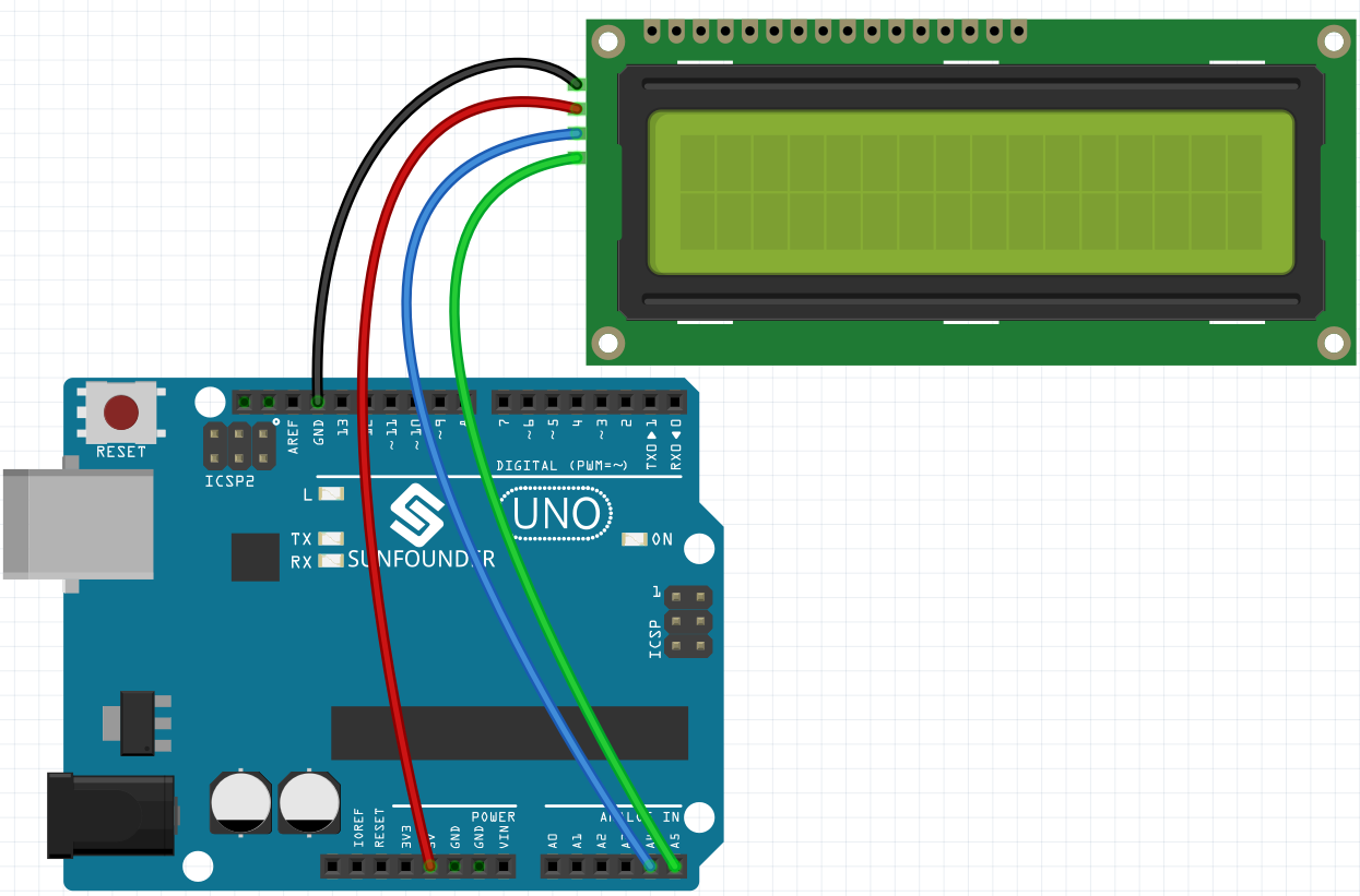

Build the Circuit
../_images/lcd1602_circuit.png

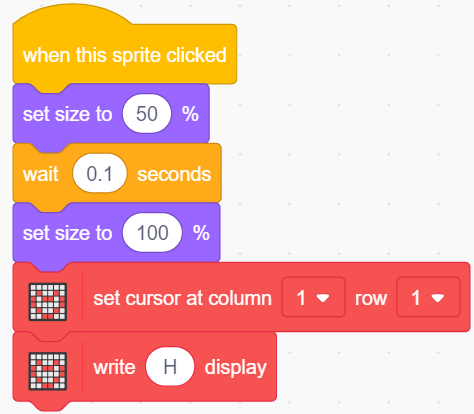

2. H is zoom in and zoom out
Click on the H sprite, and now write a script for it.
When the sprite H is clicked, make its size to 50%, then restore it; while displaying H on the first row and column of the LCD1602.
  • [set size to]: From Looks palette, used to set the size of the sprite, from 0% to 100%.
  • [set cursor at columan row]: From Display Modules palette, used to set the cursor at a specific row of the LCD1602 to start displaying characters.
  • [write display]: From the Display Modules palette, used to display characters or strings on the LCD1602.
../_images/5_h.png

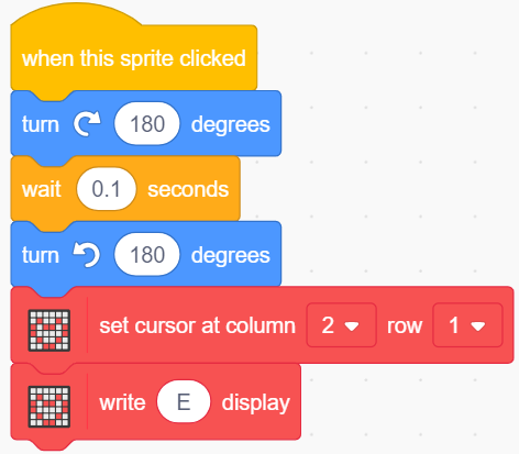

3. E is flipping left and right
Click on the E sprite, and now write a script for it.
When the sprite E is clicked, have it turn 180 degrees clockwise, then 180 degrees counterclockwise so you can see it flip left and right; and show H in the first row and column 2 of the LCD1602.
  • [turn degrees]: From the Motions palette, used to turn the sprite clockwise or counterclockwise, the range is 0-360 degrees.
../_images/5_lcd.png
