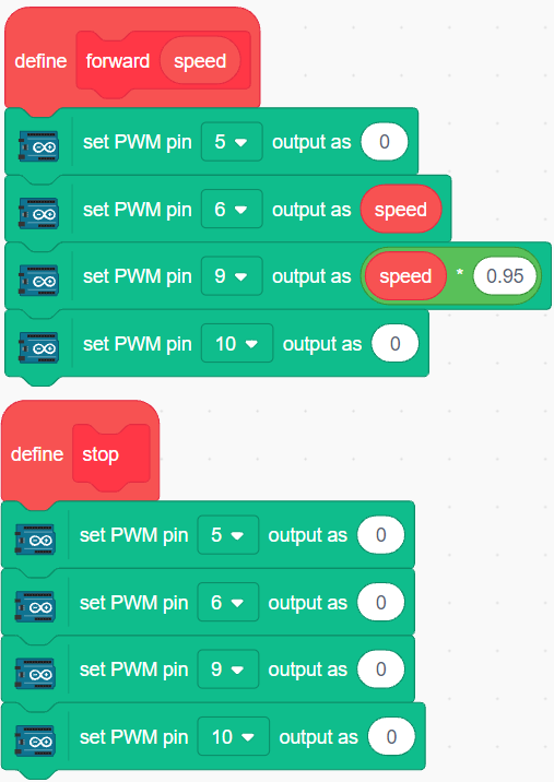

Create blocks to make the car go forward and stop.
../../_images/4_hand1.png

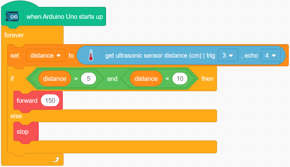

Put your hand in front of the car, then read the value of the ultrasonic module, if the detected distance of your hand is 5-10cm, then let the car go forward, otherwise stop.
../../_images/4_hand2.png
