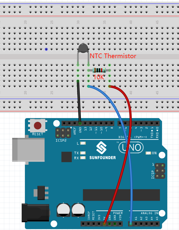

Build the Circuit
A thermistor is a type of resistor whose resistance is strongly dependent on temperature, more so than in standard resistors, and there are two types of resistors, PTC (resistance increases as temperature increases) and PTC (resistance decreases as temperature increases).
Build the circuit according to the following diagram.
One end of the thermistor is connected to GND, the other end is connected to A0, and a 10K resistor is connected in series to 5V.
The NTC thermistor is used here, so when the temperature rises, the resistance of the thermistor decreases, the voltage division of A0 decreases, and the value obtained from A0 decreases, and vice versa increases.

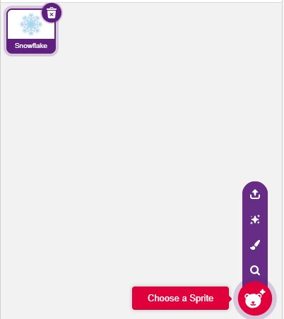

1. Select a sprite
Delete the default sprite, click the Choose a Sprite button in the lower right corner of the sprite area, enter Snowflake in the search box, and then click to add it.

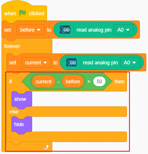

5. Determining temperature changes
Using the [if else] block, determine if the current value of A0 is 50 greater than before, which represents a decrease in temperature. At this point let Snowflake sprite show, otherwise hide.
  • [-] & [>]: subtraction and comparison operators from Operators platette.
