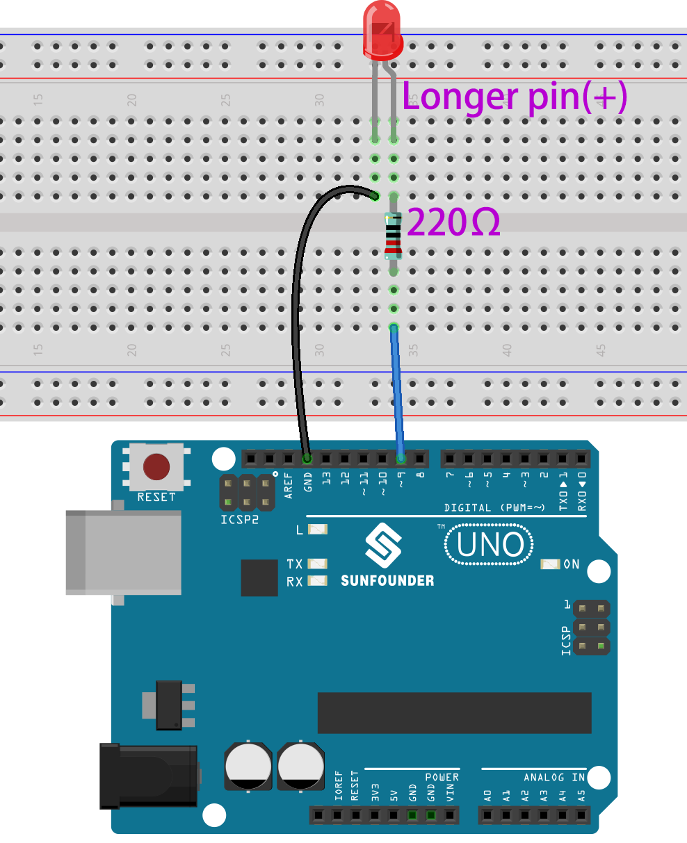

Follow the diagram below to build the circuit on the breadboard.
Since the anode of the LED (the longer pin) is connected to pin 9 through a 220Ω resistor, and the cathode of the LED is connected to GND, you can light up the LED by giving pin 9 a high level.

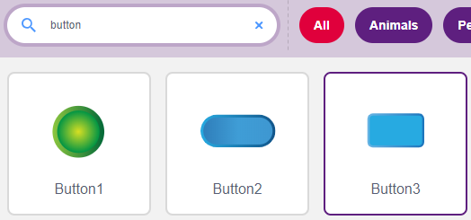

1. Select Button3 sprite
Delete the existing Tobi sprite by using the Delete button in the upper right corner, and select a sprite again.
../_images/2_tobi.png
Here, we select the Button3 sprite.
../_images/2_button3.png

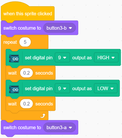

3. Make the LED blink 5 times
Use the [Repeat] block to make the LED blink 5 times (High-> LOW cycle), remember to change pin 13 to pin 9, and finally switch the costume back to button3-a.
  • [Repeat 10]: limited number of repeat loops, you can set the number of repeats yourself, from the Control palette.
